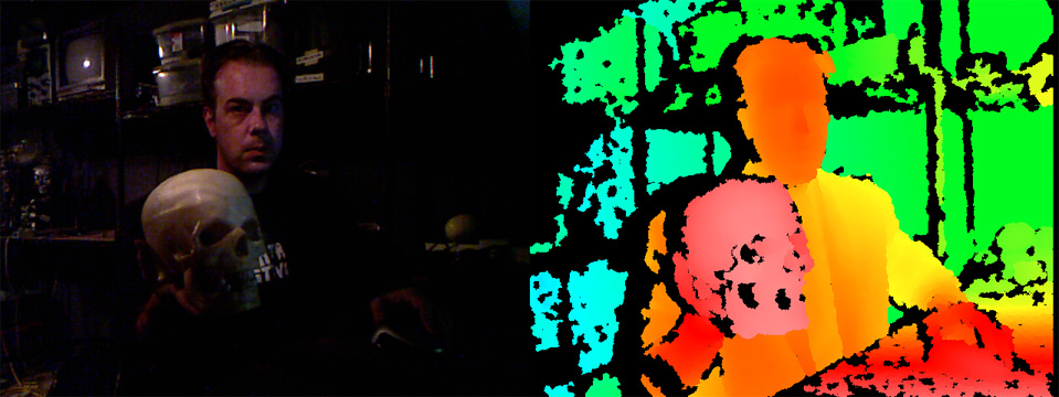

    . i have the kinect for the original xbox, so it's usb 2.0 and needs it's own power supply.
    . afaik, it sends two data streams, one is 640x480 color webcam feed (bayer filter) the other stream is depth data (which is often converted to grey scale or color) - from what i gather about the depth stream, it can be 'fine tuned' to be more or less precise.
    . here's a screen cap from cocakinect i took - http://www.npav.com/firstKinect.jpg - a very basic program someone uploaded. my thought is that these could easily be converted into their own video feed.. probably via macam or something like that.
