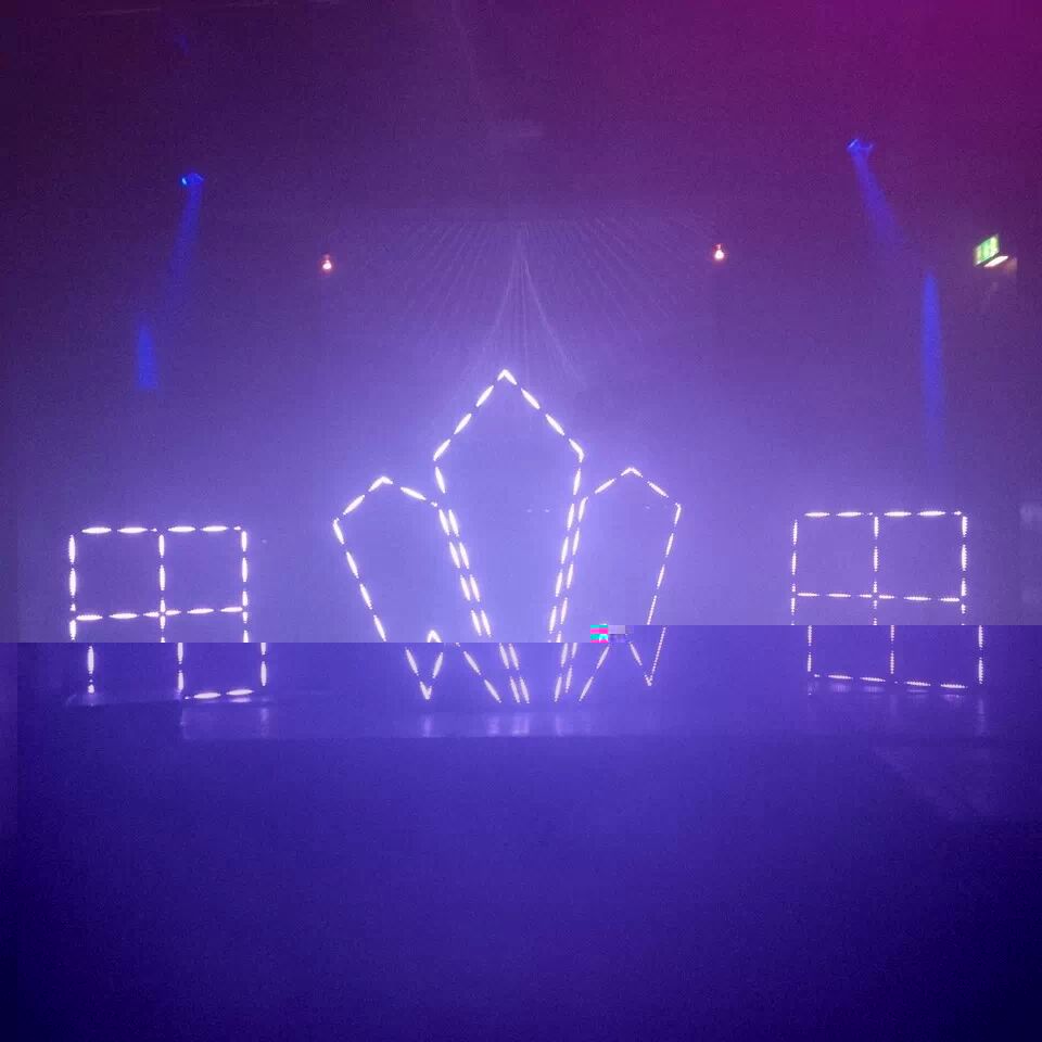

    At the moment there is no video available we are still trying to get all videos together...
    but i attached a picture of our konstukt!
    the part in the middle is our logo and we added the squares left and right.
    Kollektiv Wiebsaden
