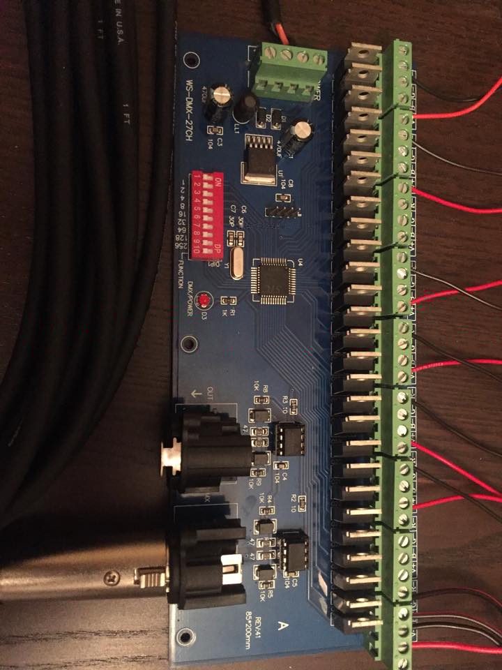

    I am trying to get my head around how to control LED strips with MadLight and I am still having a couple of problems with a new RGB strip I got from amazon today. Here is my set up:
    This is just a quick set up to get my head around it before I try to use it on a bigger one.
    The first six strips are non RGB led strips and the last one is an RGB one. The RGB strip just got in the mail yesterday and I wanted to give it a try to see if I could make it work.
    The problem with the RGB one is that I am not getting the colors I have on the input. I tried to change it to different inputs with basic colors and I can't make it match. I am almost sure this has something to do on how I set it up on MadMapper.
    Can someone try to help me out or guide me on how to set it up. If more pictures are needed I would gladly upload them. Thank you very much I would really appreciate it.

    With the RGB strips sometimes you need to change the "Pixel Type" to something else than RGB.. For my ws2812b strips I required GRB as my pixel type before the colours would match.
