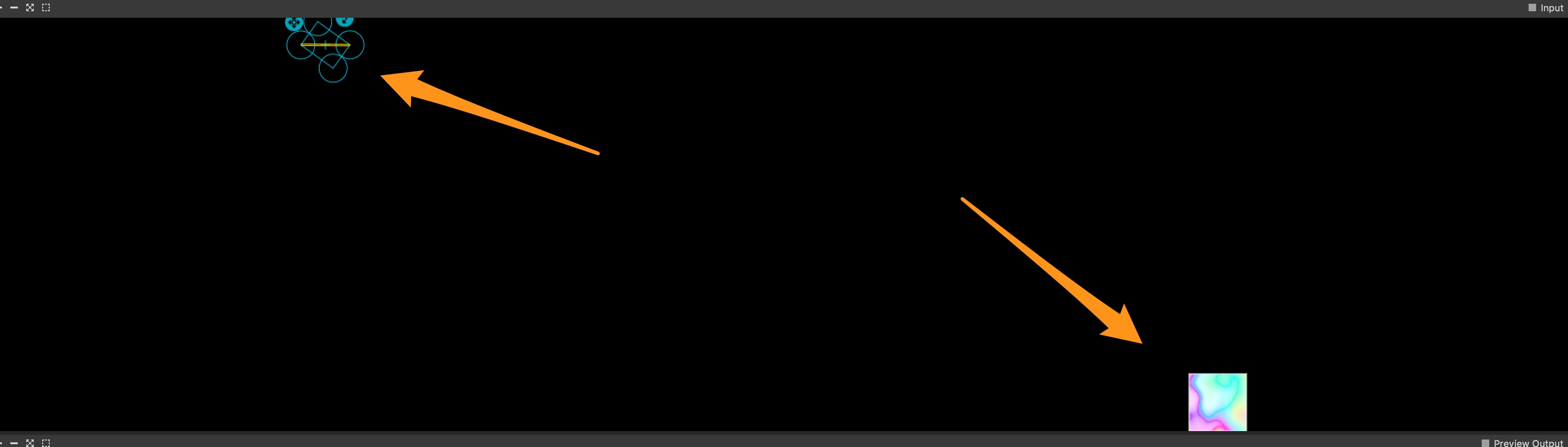

    Re: MadMapper 3.5 beta 4 BUG .
    by balamsoto » Thu Jul 12, 2018 2:31 pm
    I have the beta 4 running mostly fine.
    I notice a bug while using line texture
    after saving a file and reopen - the line quad gets displace away from texture quad.
    the displacement is big and to see it I have to Zoom in to find the line txtrue quad.
    see attach image
    Posts: 1632
    Re: MadMapper 3.5 beta released
    by mad-matt » Fri Jul 13, 2018 1:31 pm
    Is it happening just when reloading a file or when calling a cue ?
    Posts: 1632
    by mad-matt » Mon Jul 16, 2018 10:28 pm
    Ok we fixed that one. Thanks for the report.
