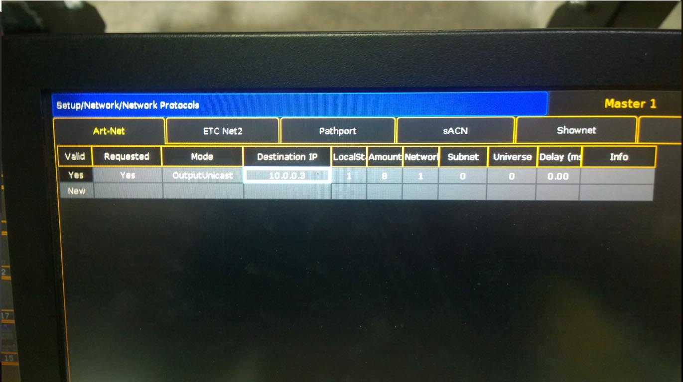

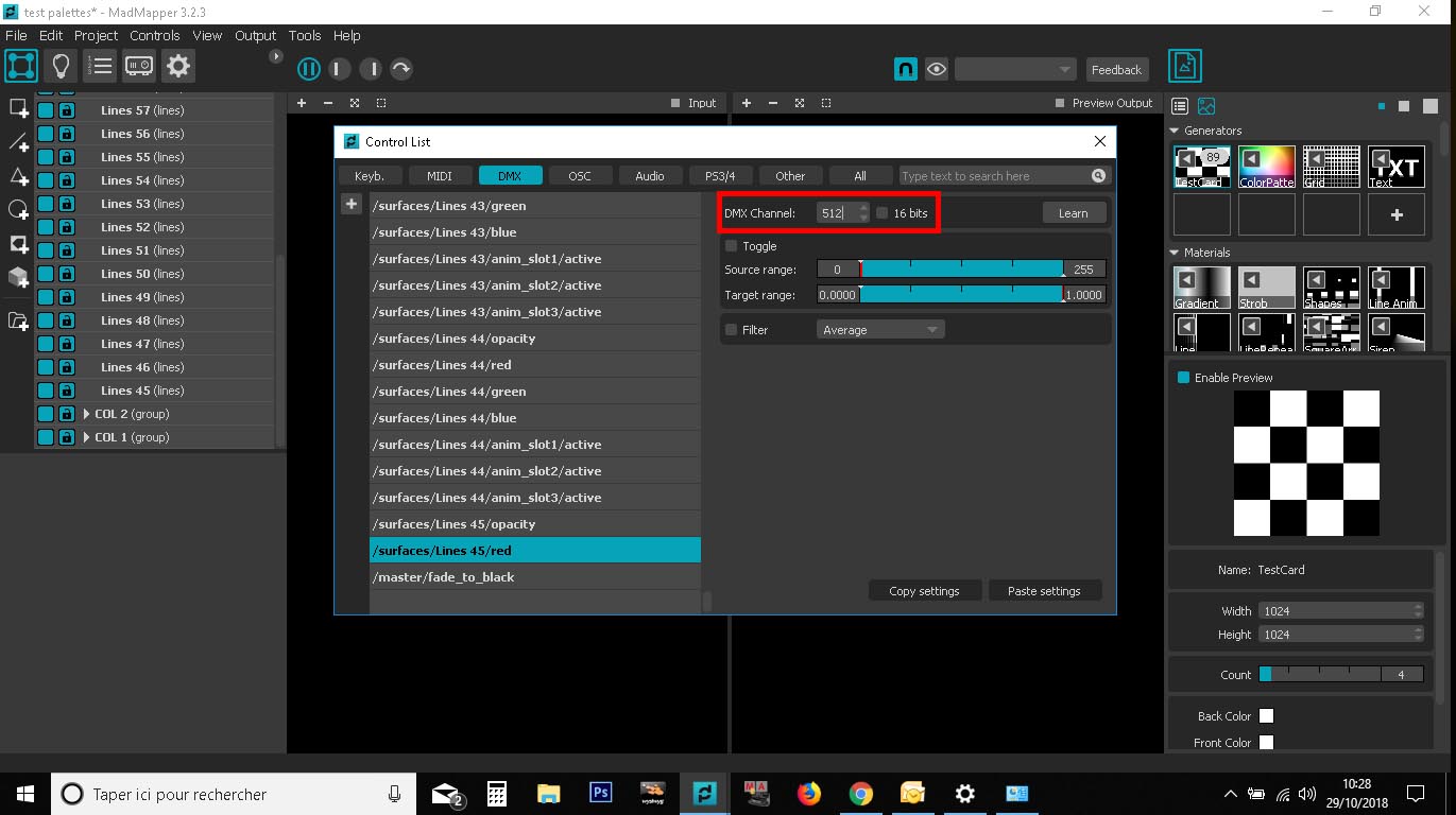

    I put you illustrations to better understand,
    my universe 1 works from 1 to 512 channels, how to do for the following?
    this view, corresponds to the control screen of the artnet of the GrandMa2, I send of the artnet of the universe 0 to 7
    in this view, we can only set the starting universe
    in this view, it is impossible to pass on the universe two

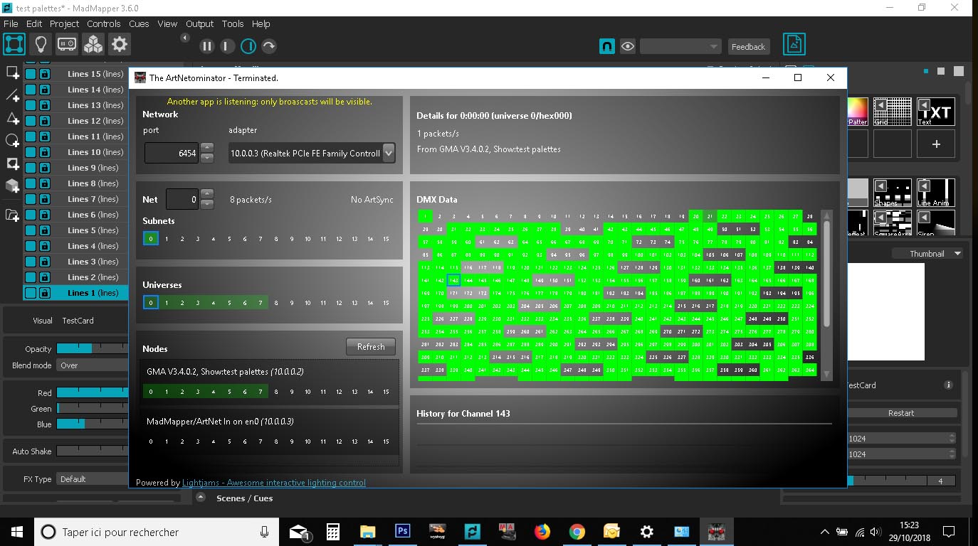

    Here, thanks to artnetominator, we can see that everything works, (channel 20 opacity line 1), but that nothing "fits" in MM, and yet the universe 1 still works .. Where is the bug?
    So we are not ready to control more than 512 parameters in artnet IN ...
    Pity

    by mad-matt » Mon Nov 05, 2018 11:00 pm
    There is an unofficial module to have 64 input universes. If you're interested, PM me. Might be shipped with MM in the future
