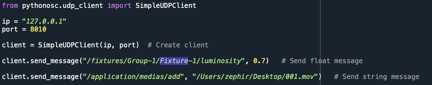

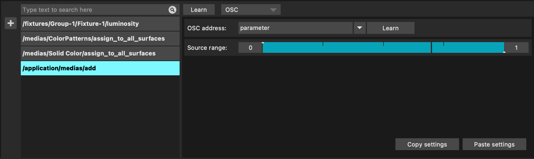

    I've tried doing this but it doesn't work. I've attached screenshots of my code / MadMapper (v4.1) controls, can you tell me if I am doing things correctly?
    (note that communicating floats though OSC like fixture luminosity works fine)

    OSC Control List in MadMapper
    Screenshot 2021-06-29 at 11.21.50.png (74.51 KiB) Viewed 3624 times

    Python Script
    Screenshot 2021-06-29 at 11.22.06.png (171.37 KiB) Viewed 3624 times

    client.send_message("/application/medias/add","/Users/.../toto.mov") will not work because SimpleUDPClient will not generate a valid OSC message. An osc message contains an address, a value type ("s" for string) and a value. It's not a simple UDP packet.
    But the idea to send a message to locahost on MadMapper OSC port, at address "/application/medias/add" with your absolute media file path as value is correct.
    You can do it with python by using an osc library: "pip install python-osc":
    from pythonosc import udp_client
    client = udp_client.SimpleUDPClient("127.0.0.1", 8010)
    client.send_message("/application/medias/add", "/Users/me/Documents/crappy.mov")
    With applescript ou can by installing sendOSC command line tool ("brew install yoggy/tap/sendosc", cf https://github.com/yoggy/sendosc). But you need XCode to be installed and up to date.
