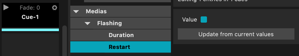

    Finally it's just a matter of cueing the "restart" parameter of your material so its time will restart anytime your trigger your cue (cf screenshot).
    Screenshot 2022-06-30 at 15.48.03.png (27.91 KiB) Viewed 2832 times
