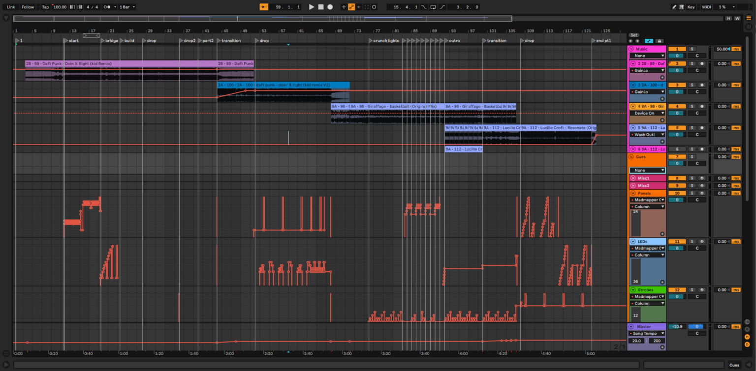

    I like to use Ableton Live (Suite) for preprogrammed sequences with music + madmapper cues. I far prefer Ableton Live to Vezier for timeline control and have made tons of programmed sequences this way, using Ableton’s automation curves for different types of madmapper cues on parallel tracks (and also using it to drive the music).
    Take a look at this live device, to simplify the madmapper integration: https://forum.garagecube.com/viewtopic.php?f=22&t=35741
