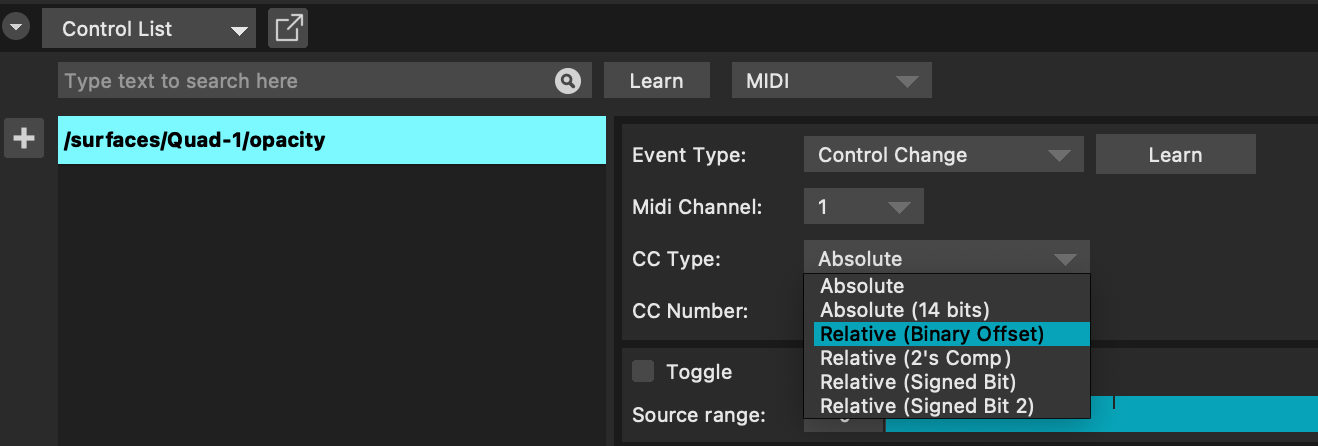

    Control List -> Midi -> Control Change : relative mode
    Screenshot 2024-04-25 at 17.45.37.png (90.52 KiB) Viewed 2415 times

    Thank you Franz for your kind answer. Unfortunately this is not what I'm looking for.
    In fact this is more setting a modifier from the actual group level to a single fixture level on the group.

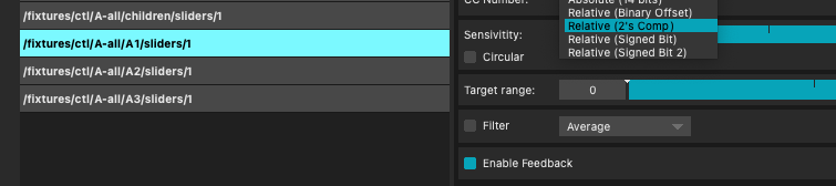

    If my group fixture set fixture level at 15000 for exemple, when I initiate the physical fader I need to stay In the range from 12500 to 17500. But if it's set at 25000, then I need to be in the range of 22500 to 27500.
    As it's a DMX winch fixture, who handle an element with 3 winches, I cannot handle a jump on the winch level.
    Screenshot 2024-04-25 at 19.45.52.png (31.91 KiB) Viewed 2409 times

    You can do it with 3 Controls Combiner Modules, one for each parameter, set the modules mode to "Add", make a control from a MIDI fader on the Input 1 of the 3 modules, and make 3 controls for the Input 2 of each module
