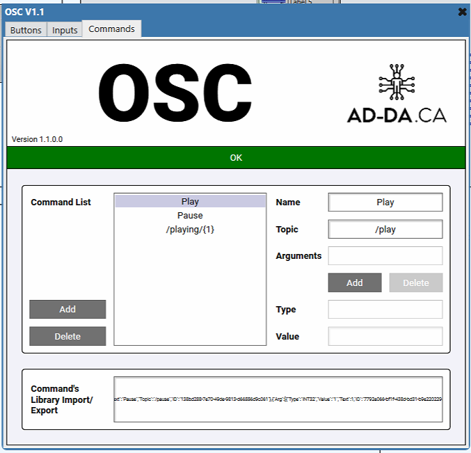

    I can still control it thru MadMapper, but if I send it an osc command of /play, it does nothing. I have also tried /playing+1, /playing1, /playing/1/ and no commands seem to work.
    I am using the TouchOSC layout and a Q-SYS OSC plugin, but it is not responsive. TouchOSC found it natively via Bonjour.

    I've tried the TouchOSC layout and cannot control the MiniMad via OSC at all. I've been using an OSC plugin for the Q-SYS control system and that is not working either.
    I'll deal with the video portions, but I do need to get OSC working. Is there a log file or anything I can check on the MiniMad itself?
    OSC Plugin
    Screenshot 2024-08-06 at 10.10.14 AM.png (77.76 KiB) Viewed 5325 times
