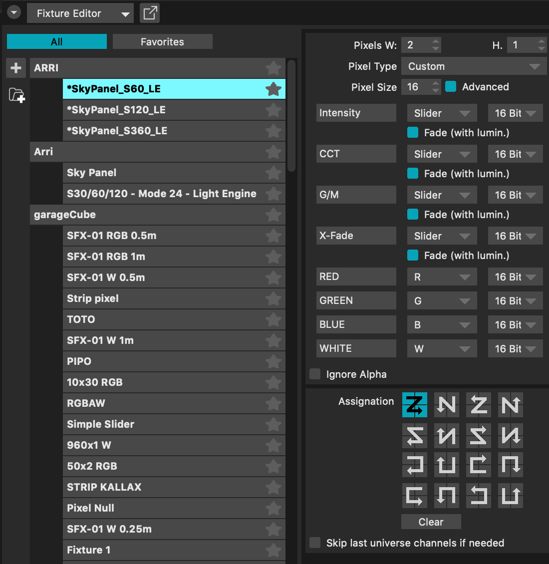

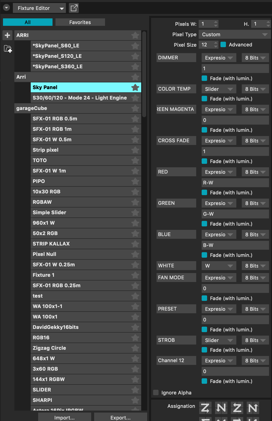

    Here are screenshots of the versions I have (one that I created, the one where white part is subtracted from RGB, and the others come from user projects I received)
    Screenshot 2022-01-18 at 10.22.37.png (187.87 KiB) Viewed 3353 times
    Screenshot 2022-01-18 at 10.22.43.png (189.92 KiB) Viewed 3353 times
