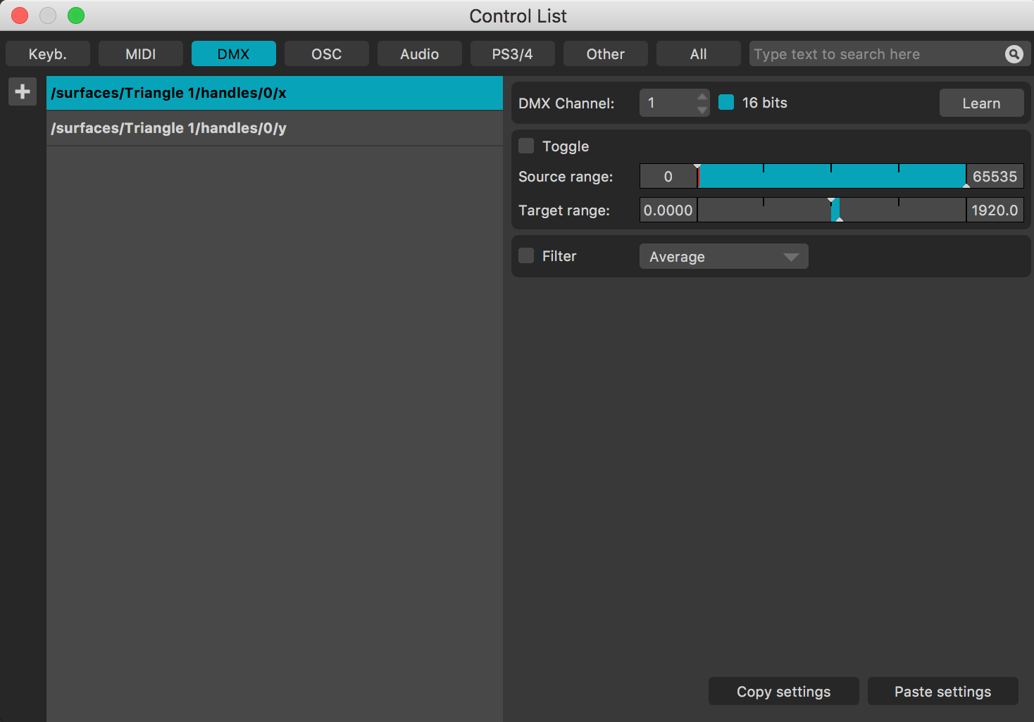

    Re: Morhping triangle
    by mad-matt » Thu Feb 22, 2018 4:36 pm
    The input value is a DMX channel (16 bits I suppose). The output is actually in a wide range, and you have to edit it. It's in pixels. You could set your assignment target range from 0-1920 for instance.
    See attached picture

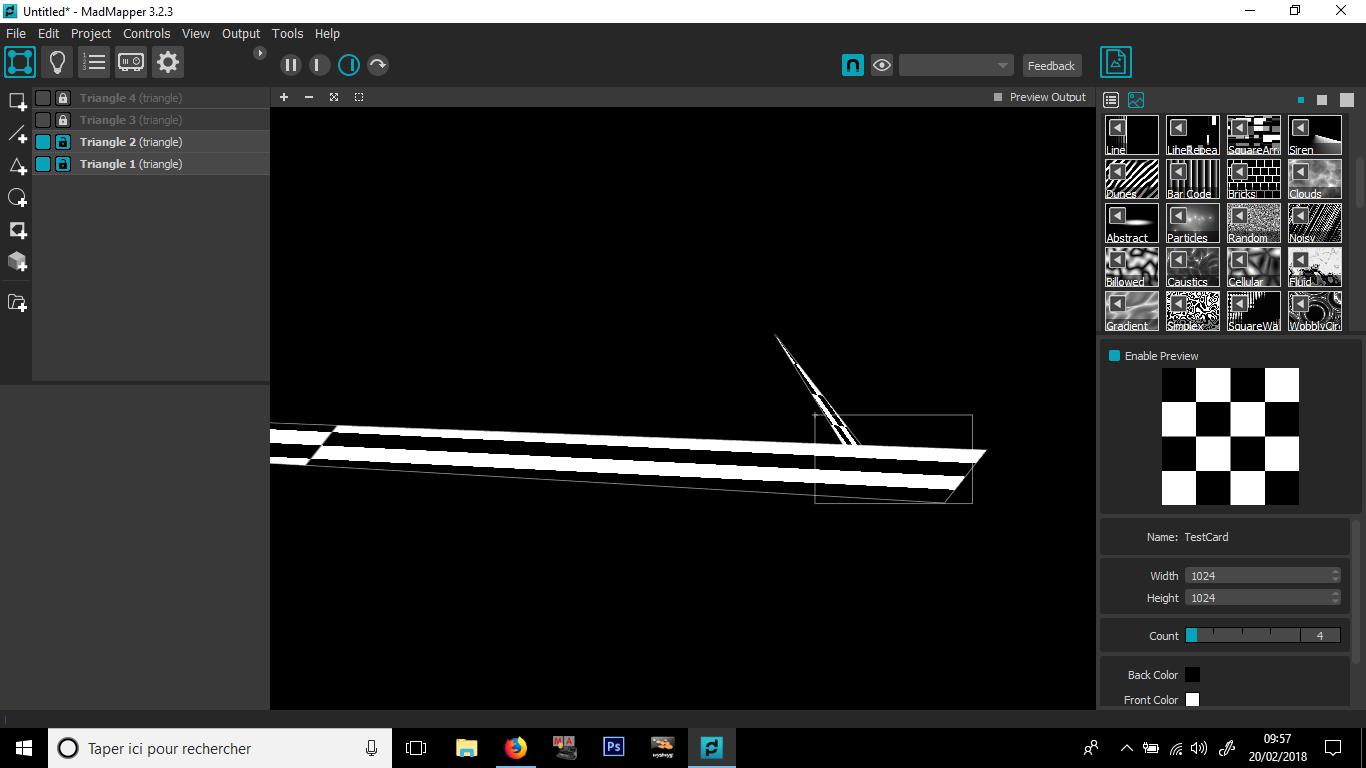

    I'm having problems again but very special.
    If you look at the screenshot, I have an eye made with lines, the patch is correct, it includes a dimmer channel and the 3 RGB channels. Each line is patched separately. And when I change the colors via the color chart of the MA2, the colors are disjointed, some lines turn on and off
    you can watch this excerpt
    www.transfernow.net/129xl638lvfy
    I think the software does not handle the DMX in.
    What do you think ?
    In addition, some addresses are "blocked" like channel 1 which is the blackout and I can not redefine it. Why ?
    In addition, do you think you can make lines in an arc?
    Last question, if I have more than 1 universe in Artnet in, how to set the following universes?
    I hope a quick answer, and thank you in advance.
    MadMapper is excellent, I really like to use it!
    white eye.jpg (130.67 KiB) Viewed 9285 times
    by mad-matt » Fri Mar 23, 2018 9:08 pm
    Hi !
    Have you activated "Use DMX Fixture" in DMX In preferences ? It should be turned off. That's why channel one handles blackout and that's why you have lines disappearing I think.
    Does it fix your issue ?
    Cheers !
