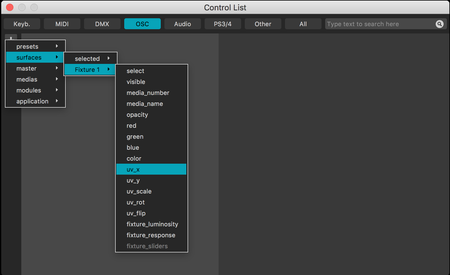

Sure, the addresses would be
/surfaces/Fixture Name/uv_x
and
/surfaces/Fixture Name/uv_y
Re: Fixture Coordinates via osc?

Doesn´t that only allow me to change the fixture location via osc?
yes, sending a float value to "/surfaces/Fixture Name/uv_x" will do the job.
In 3.5 (in beta testing at the moment), we reorganized addresses, it will be "/fixtures/Fixtures Name/input/x" & "/fixtures/Fixtures Name/input/y"
