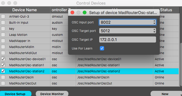

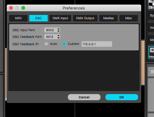

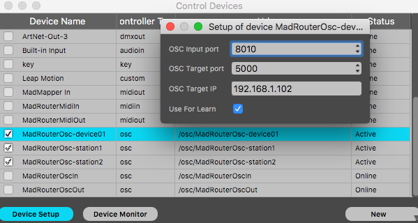

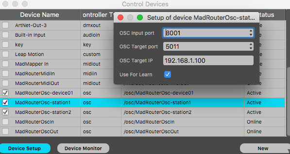

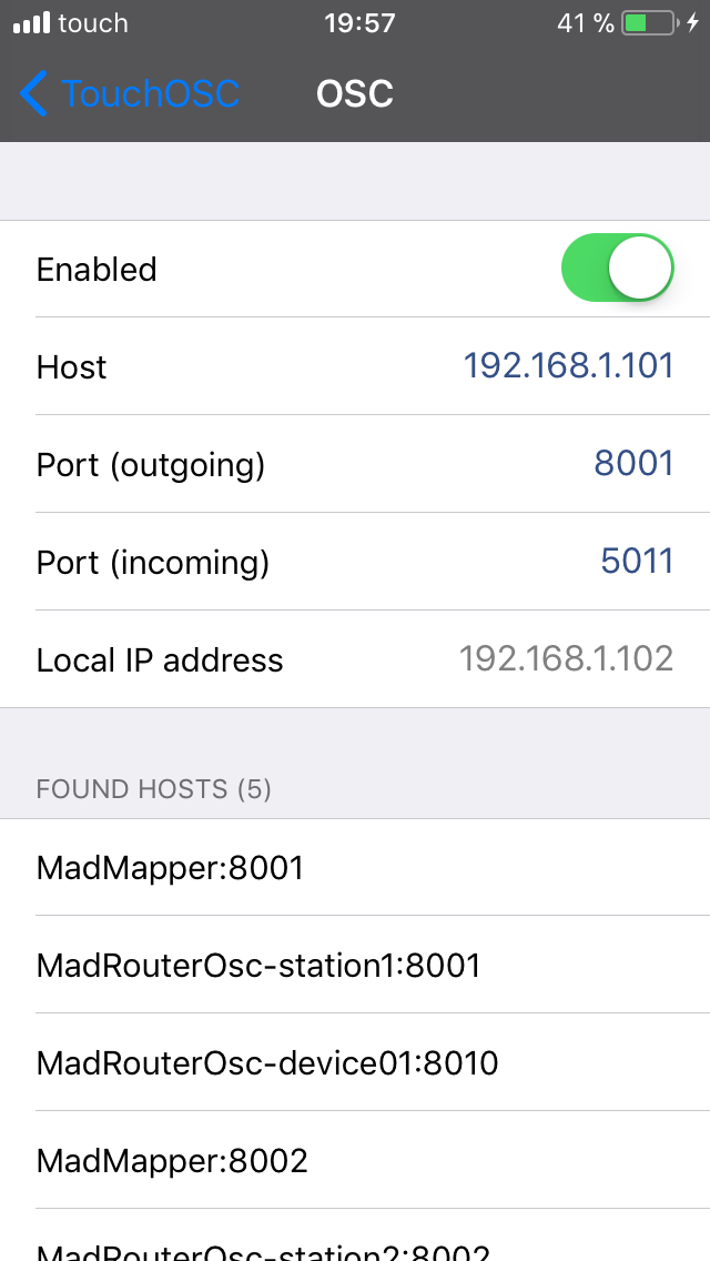

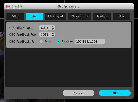

    Hello Guys,
    I have posted before a question on how to synch 2 stations, with 2 Different MadMaper Licenses, And I was answered to use the MadRouter with OSC communication methods.
    I went through all the configuration of the TouchOSC application, I was able to control directly my stations (independently), each one at a time while changing the settings on the App.
    Things got a little bit more complicated when I started using the MadRouter. I read the manual of the MadRouter, proposed on the client's page, MadRouterDocumentation.pdf. I have created a new connection (attached: MRouter_OSC_Connection_Setup.png) and I was being able to see through the device monitor that only MadRouterOsc-station1 is responding to the calls from the TouchOSC App.
    My question is: How should I configure the ports numbers, to be able to control from the TouchOSC app the two stations that I have them on the same network through the MadRouter.
    In my case (referer to the attached images, each file has the name of its usage) I'm using two Mac Stations:
    Station1: 192.168.1.100
    Station2: 192.168.1.101 (in some cases I have tried 172.0.0.1 because the MadRouter is installed on station2)
    iPhone: 192.168.1.102
    the MadRouter is installed on Station2, is it a problem, to control MadMaper from the same machine as the router?
    What should be the IP, port numbers, the connections and devices that i should create? should they have the same ports? or reversed between incoming of the stations equals to the outgoings of the MadRouter?
    I'm a little bit lost and confused between the different Input ports, and Target ports configuration from the Madmappers side and the Router side.
    Looking forward to some help,
    Many thanks,
    Issam

    by mad-matt » Wed Aug 22, 2018 10:31 am
    The principles are: TouchOSC will send OSC to only one target. You need two. So MadRouter will be used as a dispatcher: it will be the target of TouchOSC and will forward all events to both MadMappers.
    So if you have:
    You can
    MadMapper on Station1: use port 8002
    MadMapper on Station2: use port 8002
    MadRouter: use port 8001
    In Touch OSC you select MadRouter as output.
    In MadRouter, you will create two OSC output: in the Devices Dialog (menu Tools / Show Devices):
    - press "New" (bottom right) and choose "Osc Device", set name "MadMapper1"
    - select the device "MadMapper1" in the list and press "Device Setup", set the "OSC Target Port" to 8002 and "OSC Target IP" to the IP of Station1
    - same for "MadMapper2" except you put the IP of Station2
    Now you have in MadRouter:
    An OSC Device for receiving (the default one - MadRouterOscIn)
    An OSC Device for sending to MadMapper on Station 1
    An OSC Device for sending to MadMapper on Station 2
    You just need to connect the input device to both outputs, to do so:
    - On the main MadRouter window, press "Add Connection"
    - double click the "Source Url" field, choose "Preset" / Device "MadRouterOscIn" / "Any OSC Address"
    - double click the "Target Url" field, choose "Preset" / Device "MadMapper1" / "Any OSC Address"
    - Same for MadMapper2
    Now you can two connections:
    - from "/osc/MadRouterOscIn/[*]" to "/osc/MadMapper1/[*]
    - from "/osc/MadRouterOscIn/[*]" to "/osc/MadMapper2/[*]
    That's it. Let me know if it's clear.
