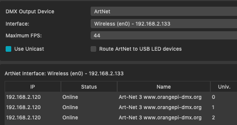

The Art-Net Poll list is given a wrong entry -> Universe 0

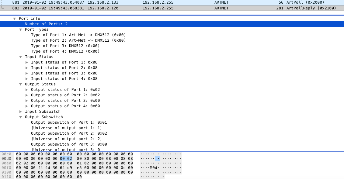

The ArtPollReply is showing 2 ports with Universe 1 & 2. However, madMapper 3.6.4 has 3 entries including Universe 0. The latter is wrong.

Hi !
It will be fixed in the next release. It happens since we fixed an issue discovering some devices, before MM was checking the GoodOutput field but some device donnot set the bit 7 (Data is being transmitted) so MM wasn't seing it, so we donnot check the good output field any more, that's why you see universe 0 in latest MadMapper releases.
Thanks for reporting!
Matthieu - MM team
Hi Matthieu,
With reference to viewtopic.php?f=20&t=33304 , it was the MergeMode which caused that the node was not visible in the list.
The Bit 7 Set – Data is being transmitted, is 0 at start. And is set when DMX data is being received and outputted.
- Arjan
