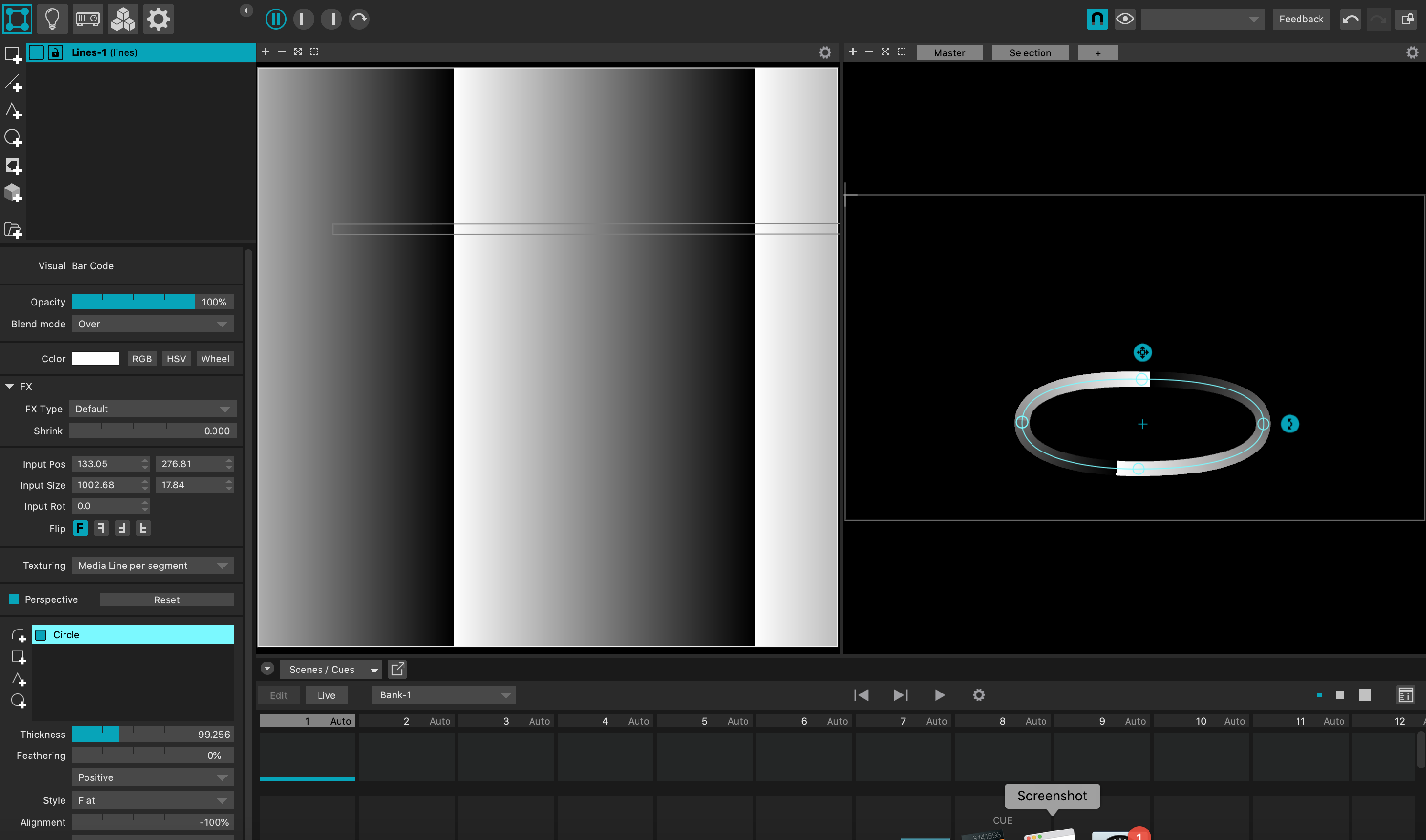

    So i've been playing with circular fixtures but the only way i can get pixels to go "around" the circle is by playing circular material. I'd like to play line material that as it moves across the screen moves all the way around a circular fixture from beginning to end and not across the circle from left to right. Is this possible?
    Cheers, Mr J
  • MisterJ
    Joined: Fri Apr 10, 2020 2:46 am
    Re: Circular LED fixture
    by MisterJ » Sun Nov 29, 2020 12:19 am
    have just figured it out... created a line surface and then added a circle to it (screenshot attached)
    works a dream and am now a very happy chappy
    rgds, Mr J
