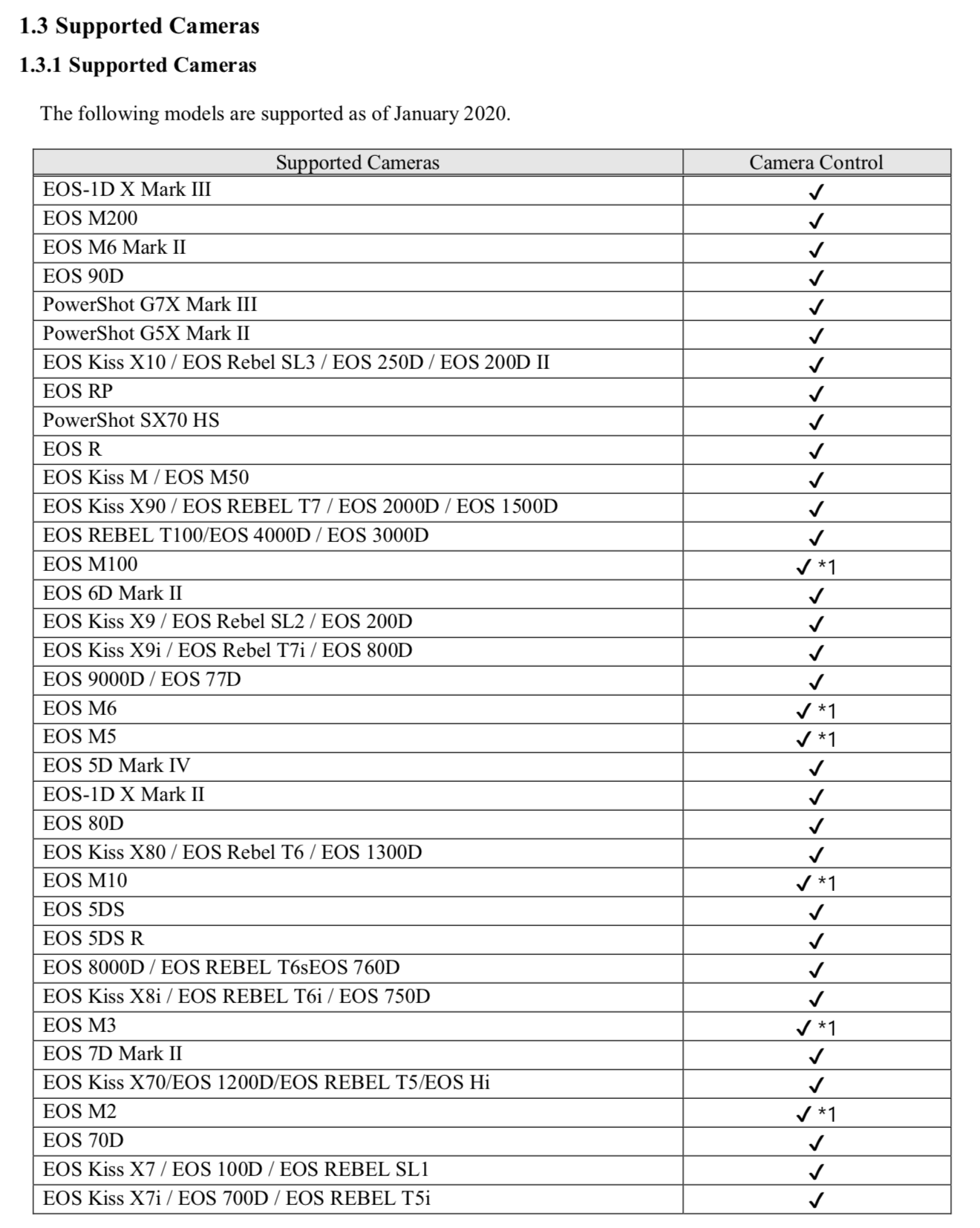

    by mad-matt » Wed Apr 22, 2020 4:59 pm
    I couldn't find a webpage, I took the list from the latest SDK which is the one MadMapper implements. We always update when there's

    Hallo ,
    thank for the List with the Camera´s.

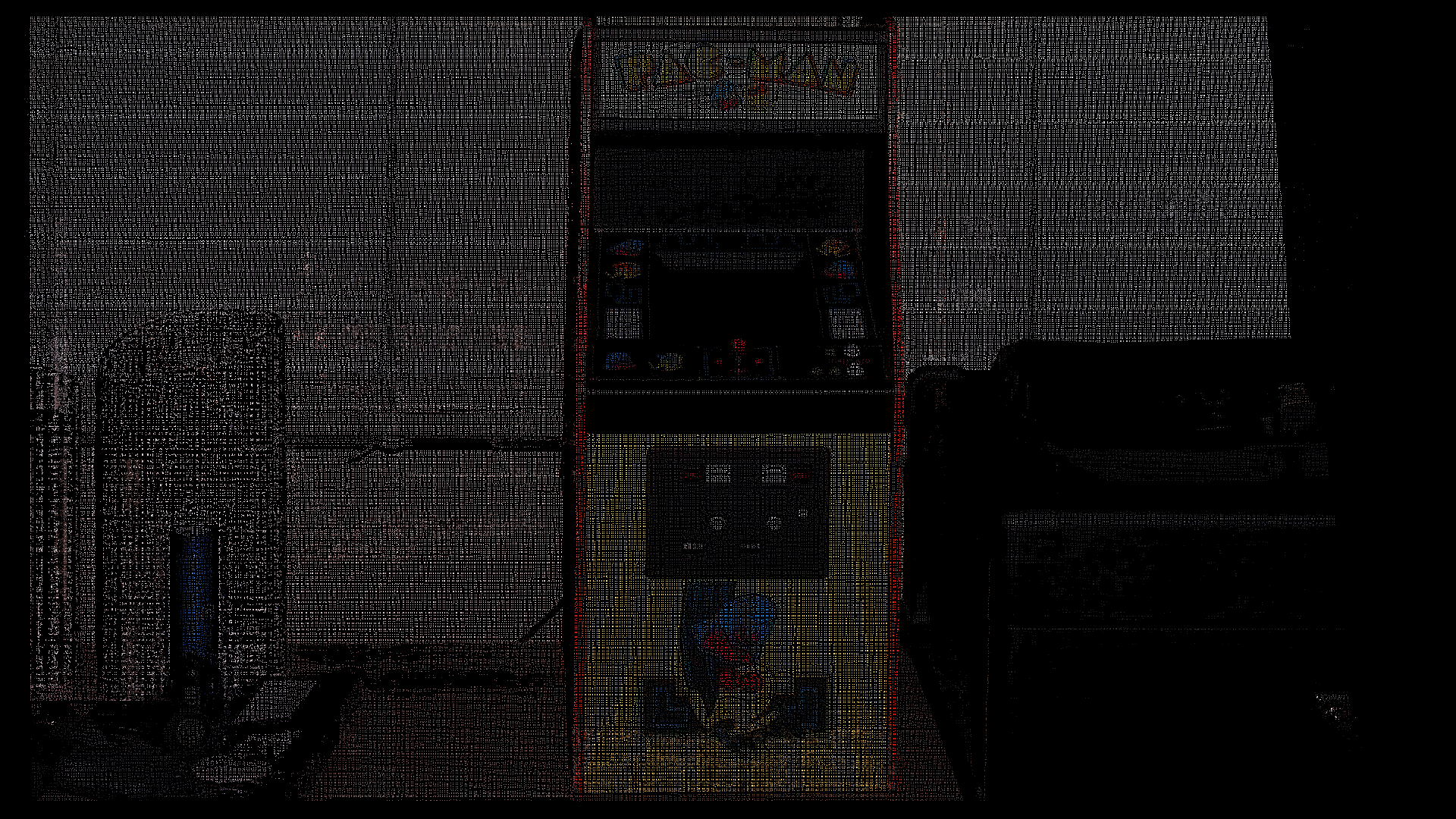

    I am using a MOKOSE 4K USB web camera with 6-12mm f1.6 varifocal manual lens. The thing is about $160 out the door. Can be found on Amazon. Use OBS Studio software (free) to make any camera system changes. Seriously cheaper and smaller than most, if not all of the recommended cameras, and does a great job with MadMapper 4.
    https://www.amazon.com/gp/product/B0814 ... UTF8&psc=1
