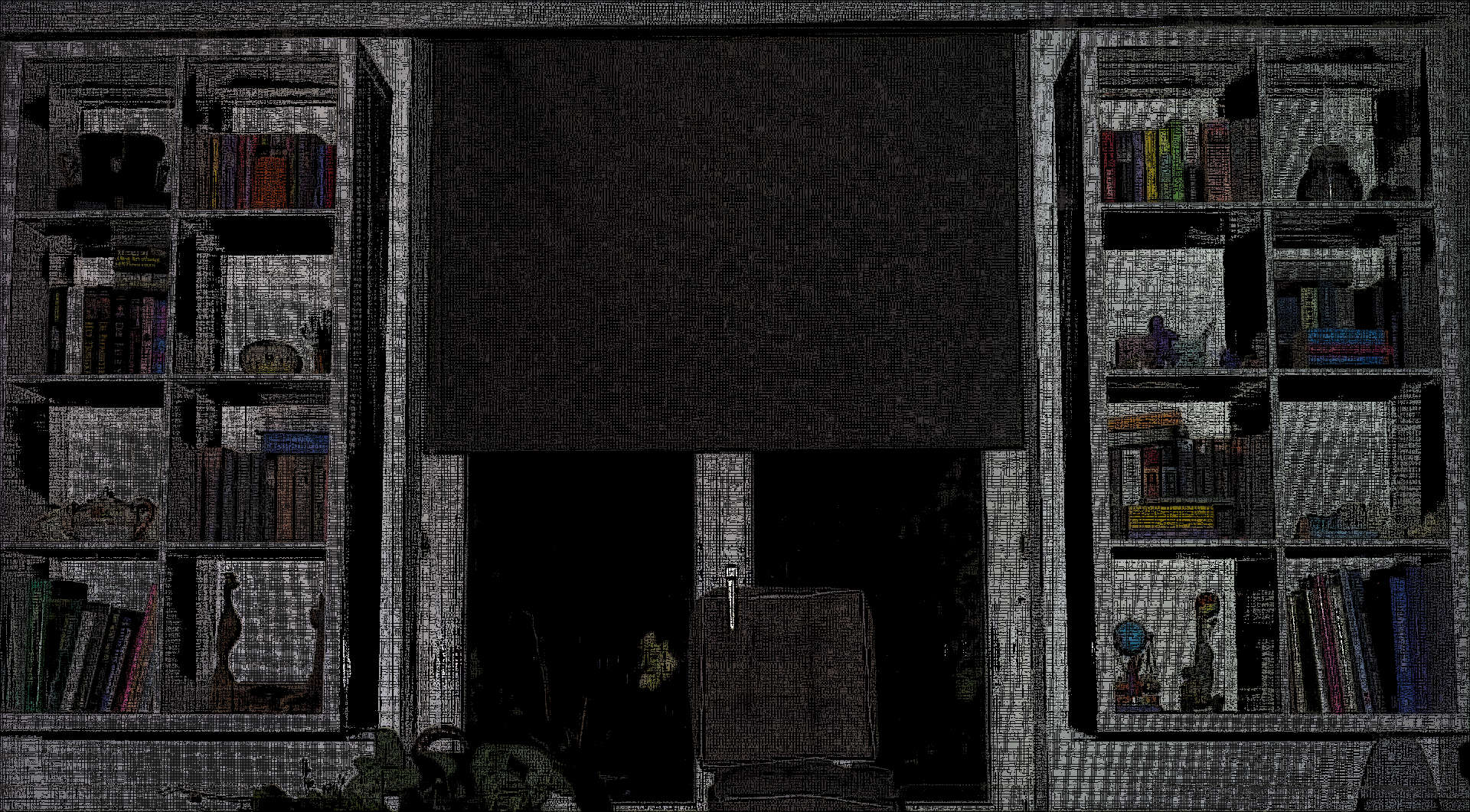

    Posts: 1111
    Re: MM-4 Space Scanner not precise
    by franz » Tue Nov 03, 2020 3:44 pm
    please post the resulting scan
  • Calysto
    Posts: 16
    Joined: Wed Oct 28, 2020 12:49 pm
    by Calysto » Fri Nov 06, 2020 2:17 pm
    I've changed the image format to JPEG to make the file size smaller.
    Posts: 1111
    by franz » Fri Nov 06, 2020 7:13 pm
    So I'd say that your scan is pretty good.

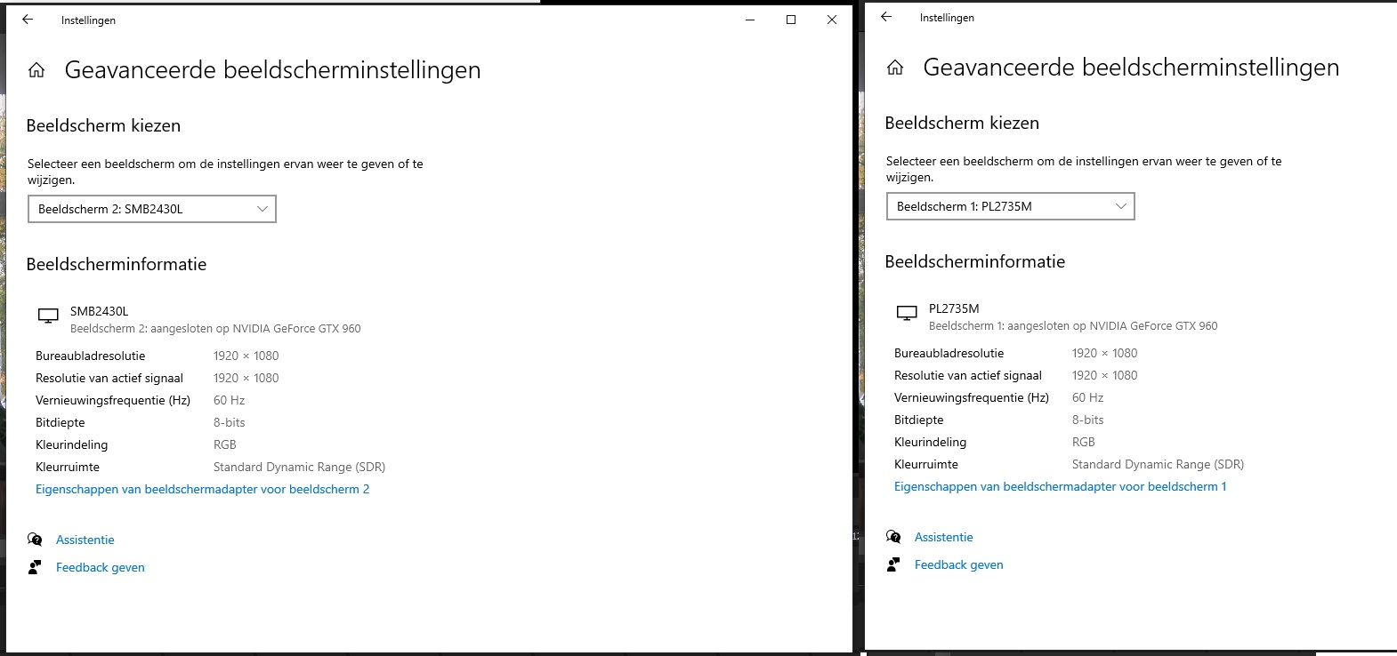

    by mad-matt » Sat Nov 07, 2020 12:06 am
    I think the problem is the bar that we can see at the bottom of the right screen in your screenshot. The fullscreen window is not taking the fullscreen. Maybe it's shifted up, or it's not as big as it should. That's not a known issue.
    Is you Windows up to date ?
    If your "Main Display" in Windows display settings set top the display with MadMapper UI ?
    Could you send a screenshot of screens configuration ?
  • Calysto
    Posts: 16
    by Calysto » Sat Nov 07, 2020 5:17 pm
    Windows version: W10 1909
    When I use the normal output, it is full screen. With other software like Vmix, it's just working fine.
    The problem occurs only when using the space scanner.
    My main display is configured as display 1, the MM UI is on there, just like the windows start-menu and the clock.
    If you want we can use teamviewer, you can look at all the options...
