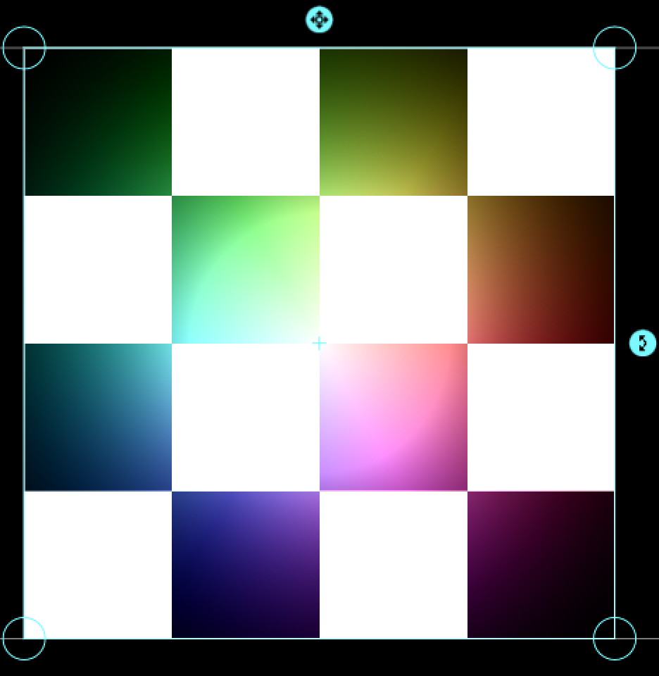

    I would like to simply project a video loop (place in Quad-2 with blend mode set to Add or Over) with a any background generators, materials or videos (place in Quad-1)
    The desire behavior is to see the content of the video clearly with the black video background replaced by the content set in Quad-2. Like a whatever video editing software, instead I see the content of the video in semi-transparency
    I searched on internet but I founded only YouTube channel tutorial related MadMapper3. I tried it but in MadMapper4 the result is different. The black color of background in video is transparent (and this is ok) but the rest of video content is semi-transparent and I glimpse the Quad-1.
    I also did a test with only built-in generators:
    - Quad-2 ColorPatterns (blend mode set to Add or Over, I tried whole blend modes)
    - Quad-1 TestCard
    The result is the same. I glimpse testCard image where there is ColorPatterns.
    How can I obtain the result like a whatever video editing software?

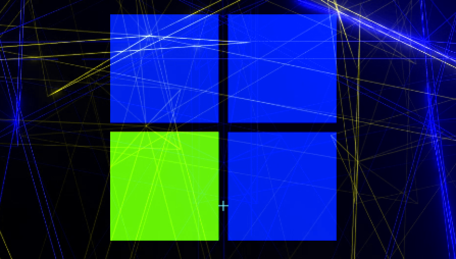

    Thank you Franz. But my problem is more simple I think. The background is already removed and this is ok.
    But is the foreground the issue. I see the surface below.
    Which is the correct blend mode to show the foreground of the last surface (Quad-2)?
    In attached there are 2 example of the problem.
    Thank you.
    Roberto.

    OVER Blend Mode
    In Over Blend Mode I can't see the surface Quad-1

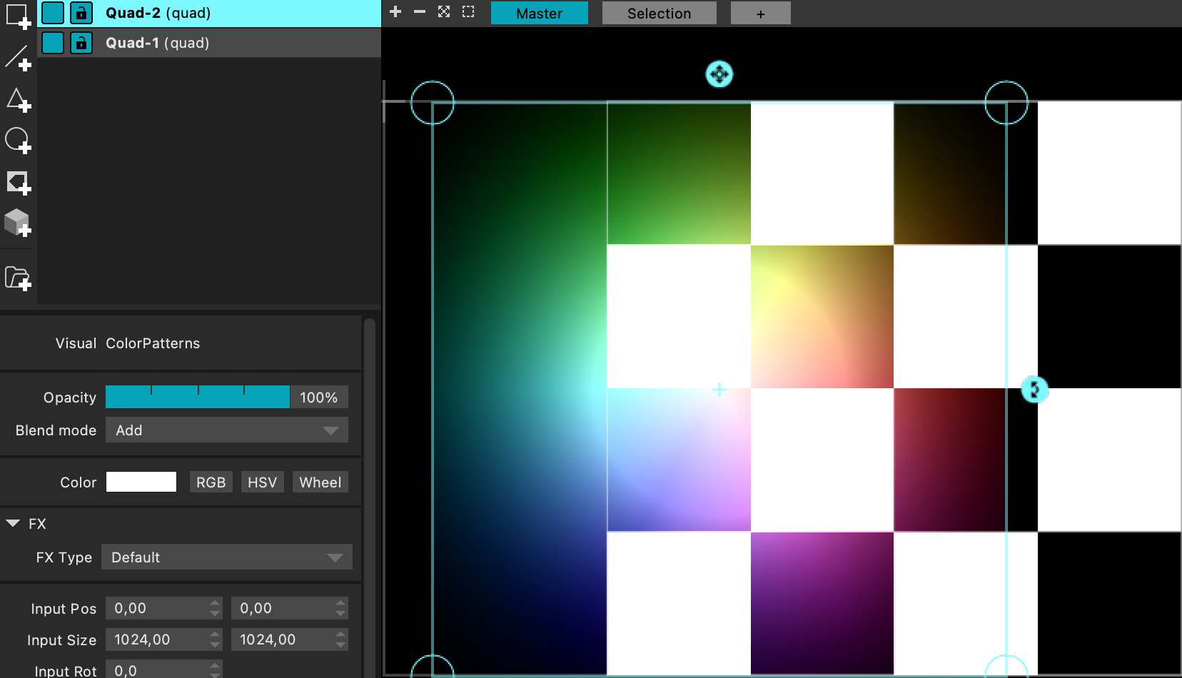

    ADD Blend Mode
    In Add Blend Mode the circle rainbow is semi transparent. I would like to see it in full color and full opacity
