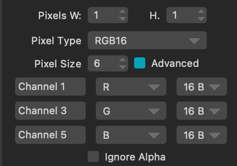

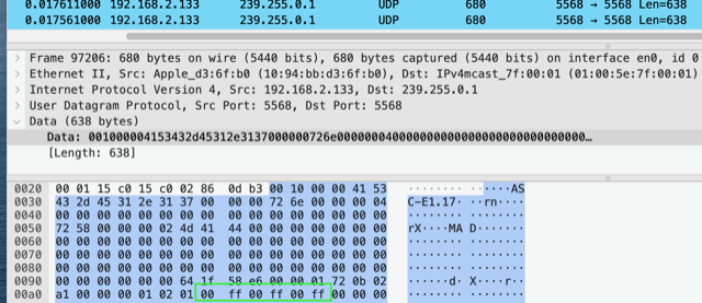

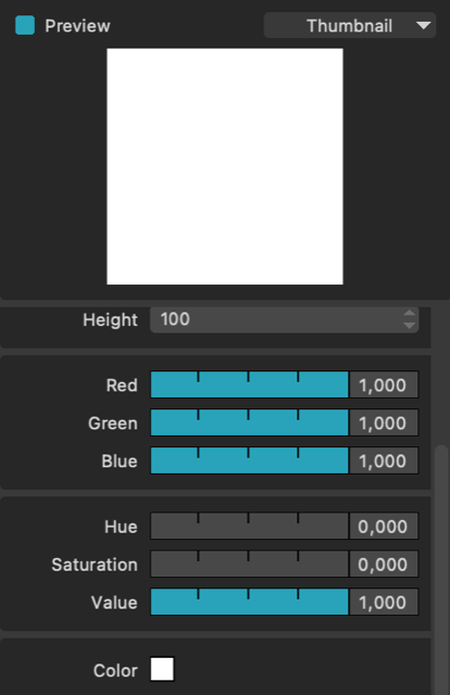

    I have selected a Pixel type 16-bit and a solid color white. Just checking with Wireshark I would expect to see 6x 0xFF. However, there are just 3 times 0xFF.
    What I am missing here?

    I remember there was an issue with 16 bits colors that was solved a while ago. Which version are you using ? I just tested in 4.1.1 and it just looks perfect (0xFF for all 6 bytes)
