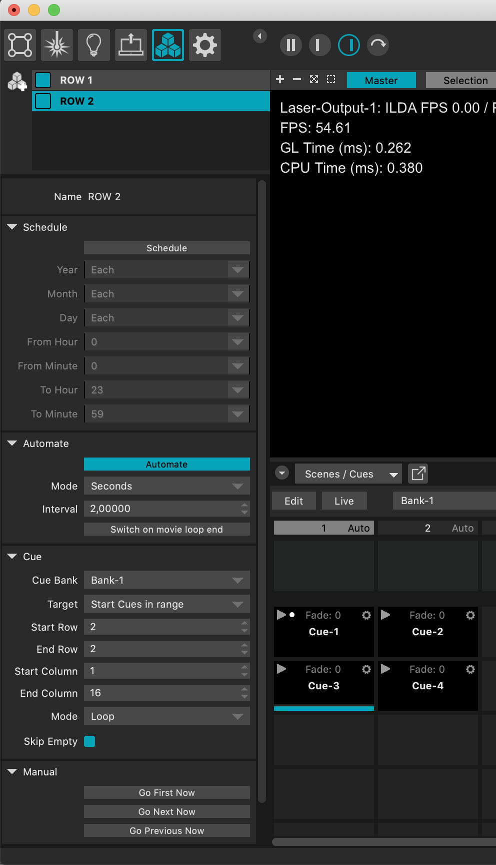

    E.g. I want to loop row 10 cue 1-2, all other cues in row 1-2 get triggered as well, I understood that this is the concept: I trigger a column and all cues in this column will be triggered at the same time. If that is the case, I don't unterstand the possibility to Start a "specific cue" or "Start Cues in Range". It would be great to describe the behavior and idea behind in the Userguide of the Cue Scheduler.
    I don't understand, if you select "Start Cues in Range", it will just trigger the cue in the range (ie start row 2 - end row 2 => will only start cues on row 2). Isn't it ? I just tested and it's ok.
    Screenshot 2021-12-09 at 16.15.12.png (196.61 KiB) Viewed 2977 times
