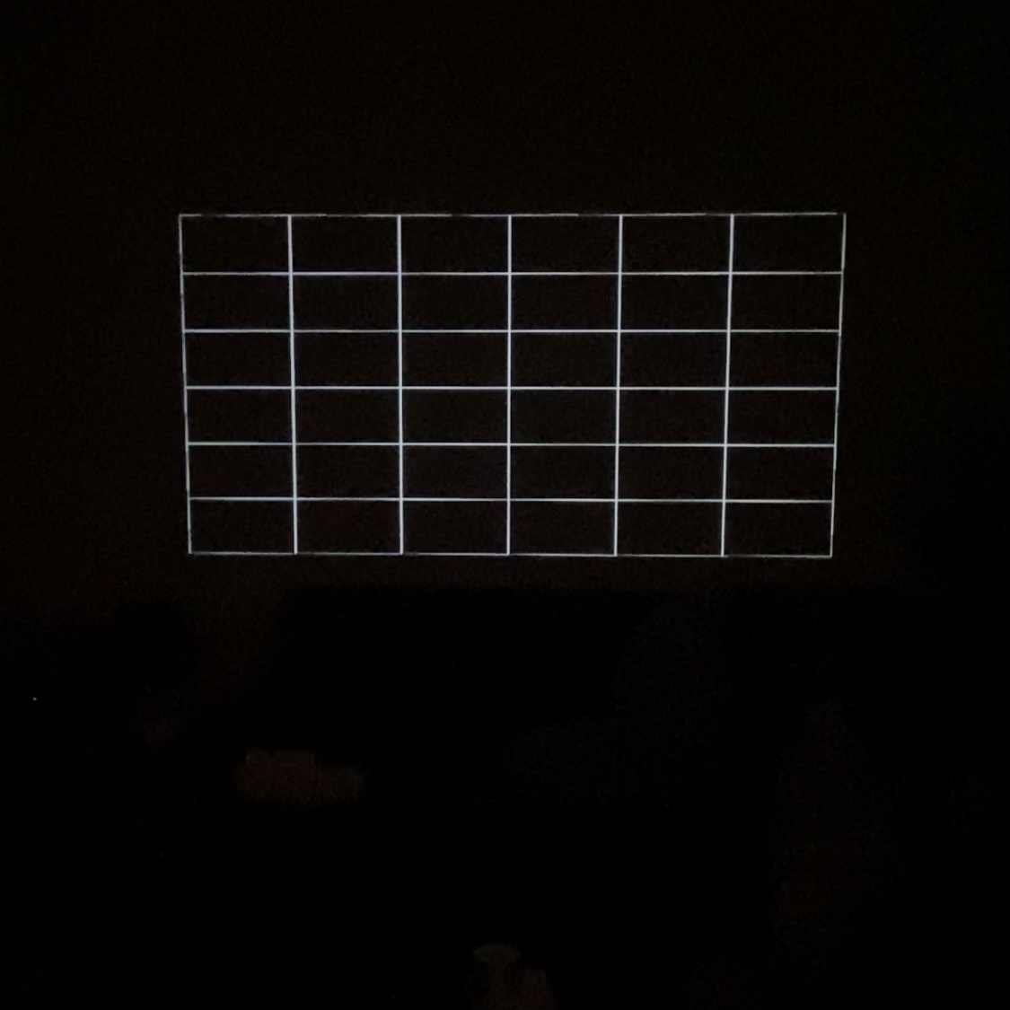

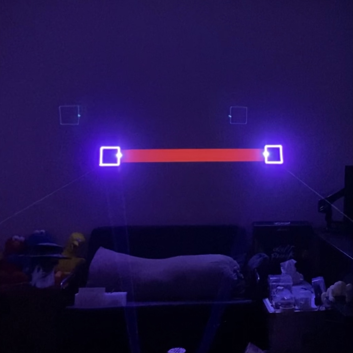

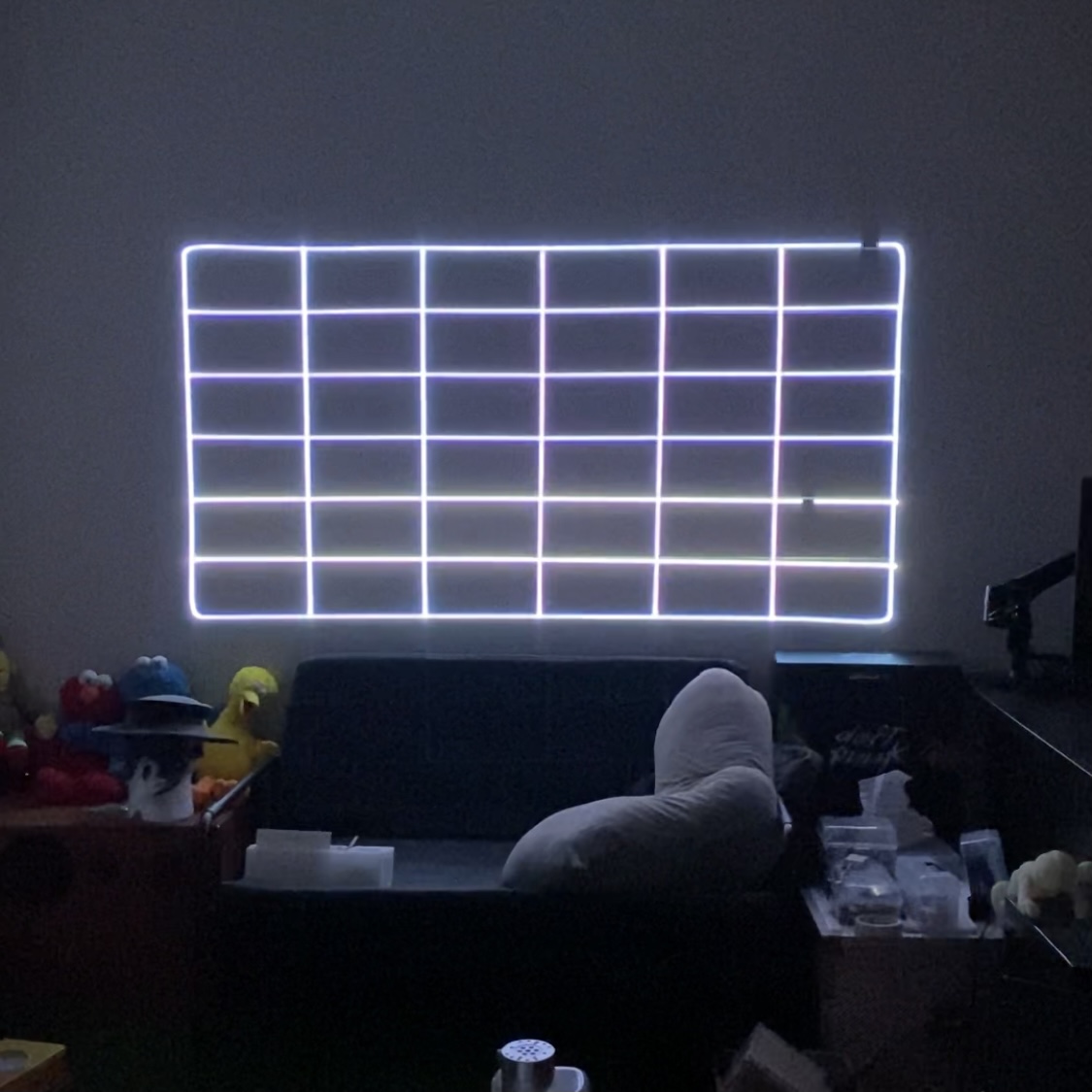

    THANKS MATT ! It works now ! So I've had success with a PC routing all 3 Lasers, Lasercube PRO 2.5W x2, and Lasercube USB 1W. However on an M1 Mac, it detects the Lasercube USB, and you are able to see it on the dropdown box, but it cant output anything. I've tried to test with LaserOs and also Modulasers both detects the Lasercube USB 1W, not sure if its a Mac thing or what. Also for the custom scanrates, I cant seem to set to 35kpps, it'll either freeze or no output for both Mac and PC.
    Attached are some tests that I've done, matching projection output with 3 laser dispatch, and also having 3 lasers aligned but playing separate parts of content.
    Thanks again for the update !
