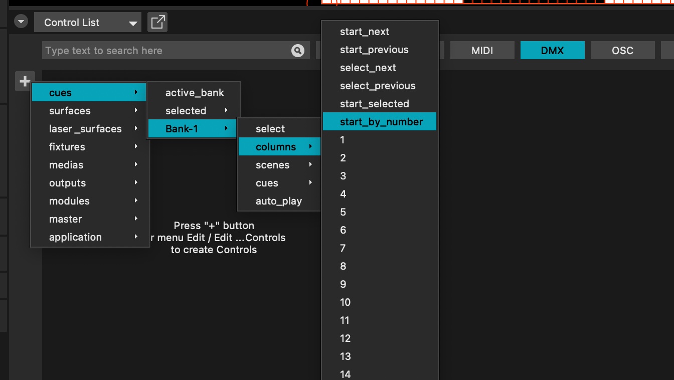

    Re: Remoting Madmapper with the GrandMA 2
    by mad-matt » Sun Jul 16, 2023 10:38 pm
    You can use the "/cues/bank-1/columns/start_by_number"
