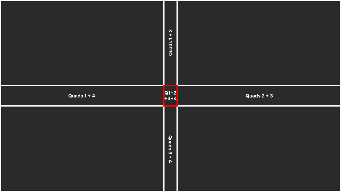

    I have a Soft Edge interrogation: in short, is the kind of 2x2 projectors setup I'm showing in the attached pictures possible easily in MadMapper?
    More specifically, I'm wondering about the brightness of the zone I've circled in red, where all 4 quads overlap. I understand that I can adjust the soft edge on all four dimensions of each quad, but how do I take into account the fact that there are four quads overlapping in this spot and not only two?
    Won't the brightness look weird? Should I mask this zone in two of the quads so that it becomes a blending between only two?

    preview of the 4 projectors in MM
    drawing of the overlapping zones

    If your video projectors have a about the same luminosity response to input signal (gamma), it will work like that.
    Great, thanks for the reply!
