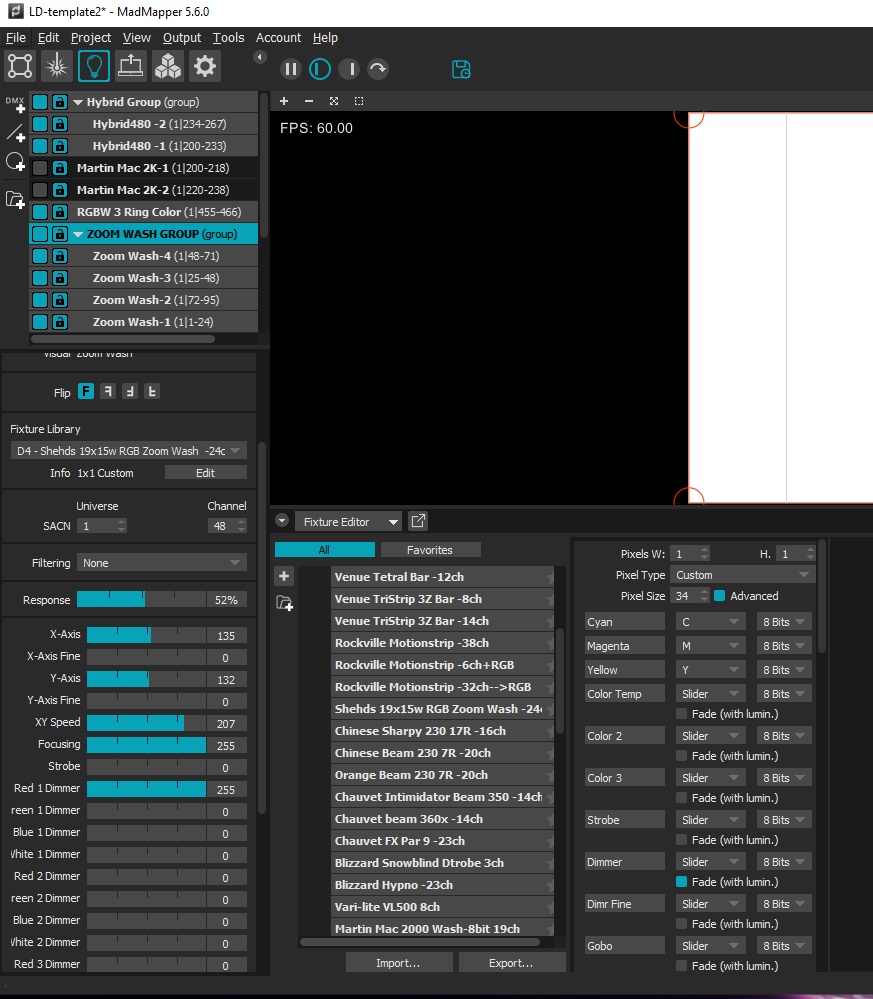

    The input tab is a used for input geometry. You need to build a DMX Profile using the Fixture Editor. Check your fixture's manual for correlating channel functions. See attached screenshot.
    This link might help for more advanced control.
    https://forum.garagecube.com/viewtopic.php?f=29&t=36164
    Screenshot (98).jpg (215.31 KiB) Viewed 4635 times
