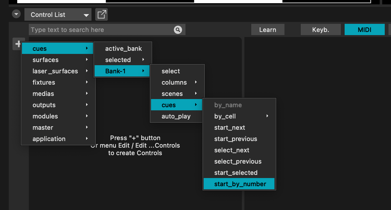

    I would like to trigger my laser cues by Art-Net DMX. I created cue and control with DMX Input. My goal is:
    • send on a channel "the cue number"
    I created a control that trigger my cue start on DMX Channel 250. But I don't know how to use the value sent to my DMX channel.
    It seems like it's only possible to trigger action on a channel, not on a value on a channel.
    Thanks

    There is a solution, from controls list add a control to "/cues/selected/cues/start_by_number"
    Screenshot 2024-12-08 at 13.57.13.png (236.42 KiB) Viewed 4479 times

    Thanks for this feedback. I was using the 6beta3 and it's not organized the same way for controls. Your solution works fine with the release 5, many thanks.
    Support team made a proposal: use module Timeline scheduler, another way of answering my request.
