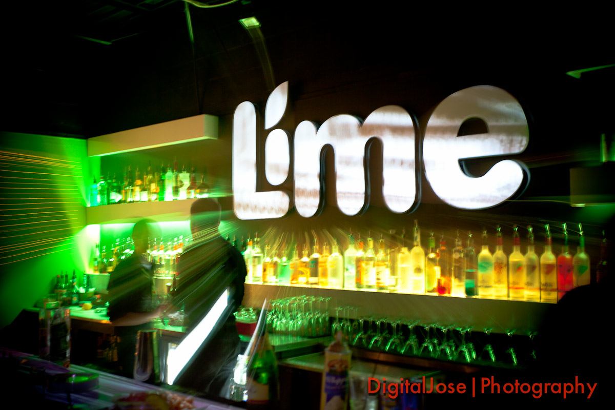

    Just to make it clear what I'm doing (and I'm currently doing it with Modul8, not MadMapper), see the following image. I'm projecting video the Lime letters with video...

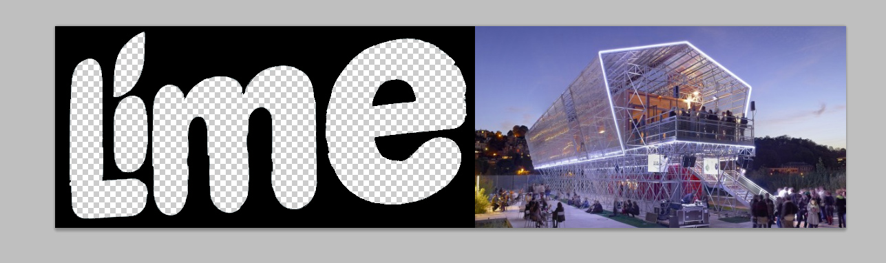

    first picture : in photoshop (or after effects, or in modul8 with video)
    your mask + your content, with alpha, saved as png (or any format preserving alpha)

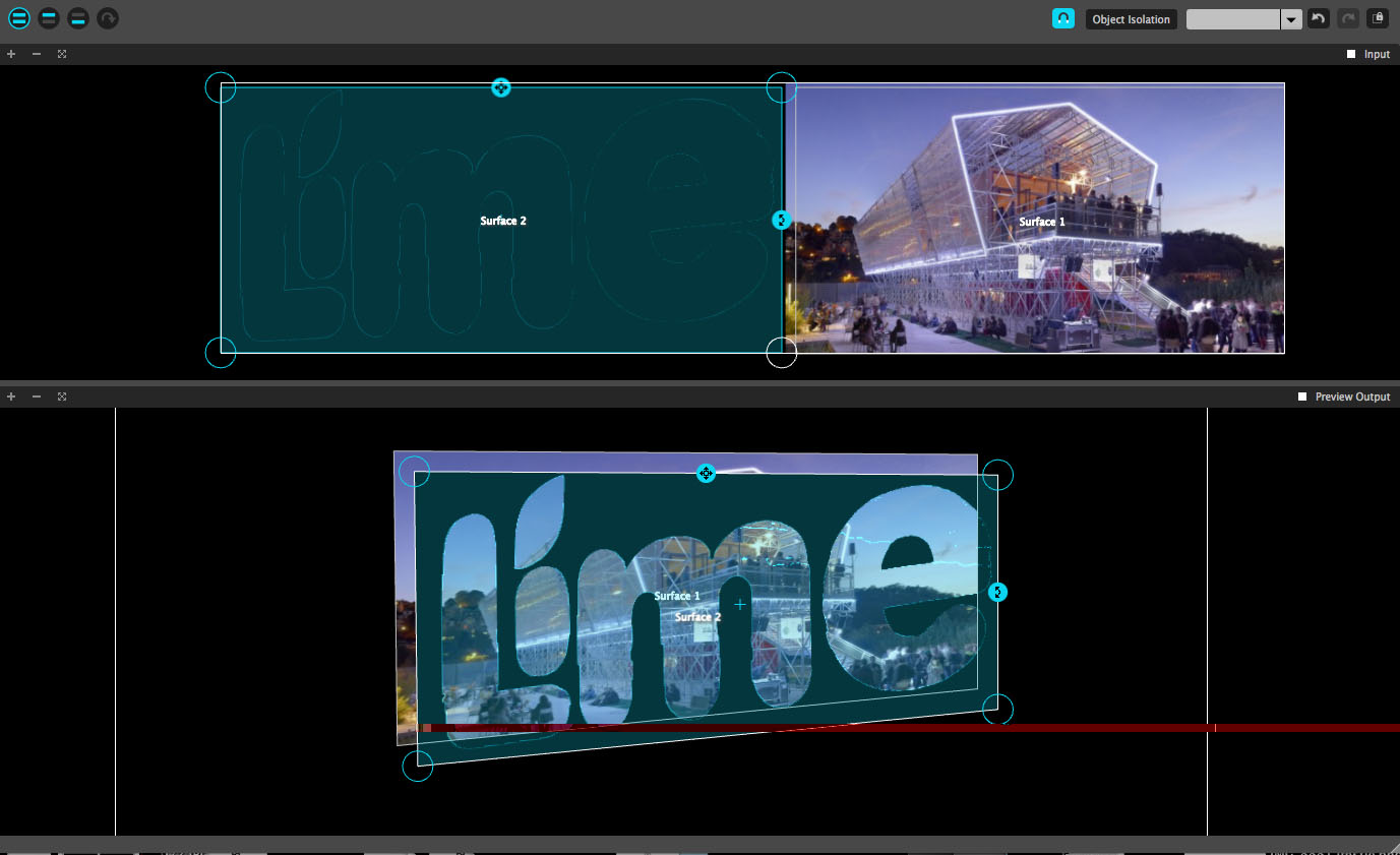

    second picture: in madmapper, 2 quads...
    Posts: 1111
    Re: Seemingly Simple Question
    by franz » Fri Jan 20, 2012 12:03 am
    and the 2nd pic:

    Thanks for the illustrated tutorial :D I may give MM another shot, though not likely on this particular project (I'm also running another three projectors to do a bar top--not shown in the photo)...
