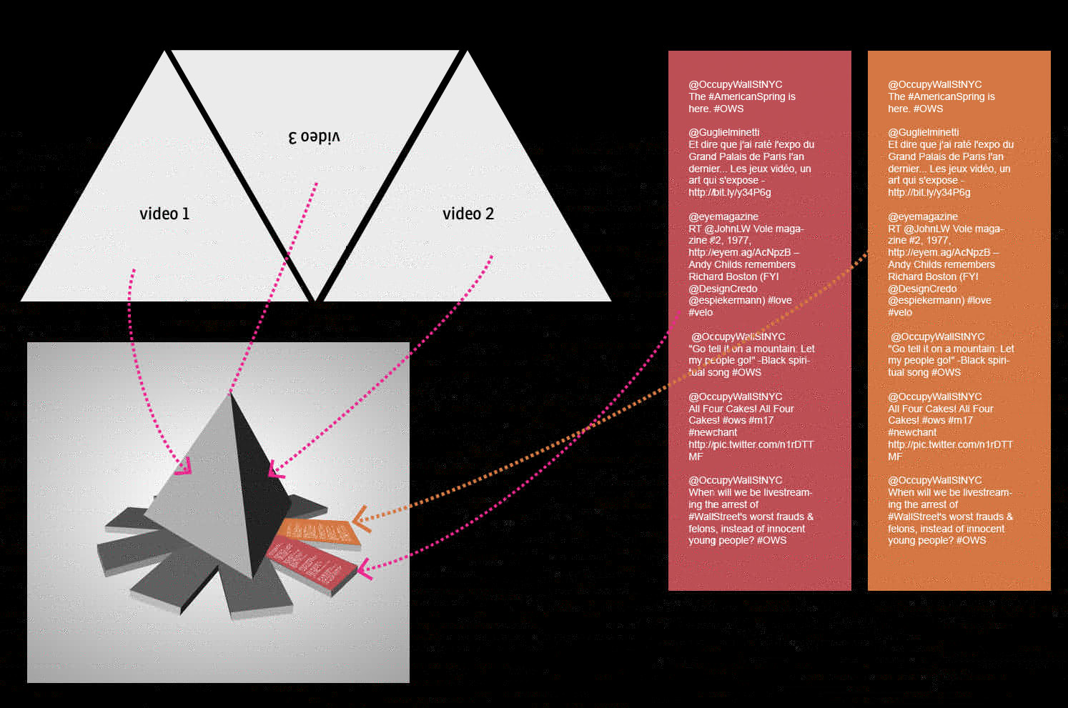

    Just posting a kick sketch of the installation so you can better visualize it.
    Two computer with two projector is not a bad idea, but do you think it will really make a difference ?
    And I would have a problem of overlapping each other since both projectors have to project
    from the center top..

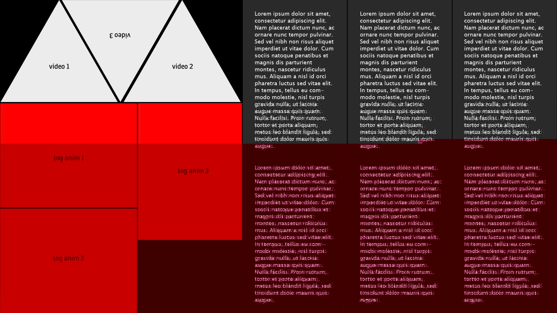

    Lets say I have 1920x1080 pixel to play with.
    Lets say I "place" all my element like in this sketch attached... (it can probably be better place but just for the sake of the discussion).
    The triangle doesn't take that much space...
    I'm thinking, if I can reduce the distance between the installation and the projector, the pixel will be smaller, thus a better quality...
    The projector would hang over the installation a bit lower, so we it wont be "hidden" but if the quality is better than maybe its a workaround...

    Maybe one projector doing 1 face of the pyramid and 4 logs and another doing the remaining 2 faces and the other 4 logs
    Projectors would be lower, i admit, but brighter and more pixel coverage
    Worth thinking about
