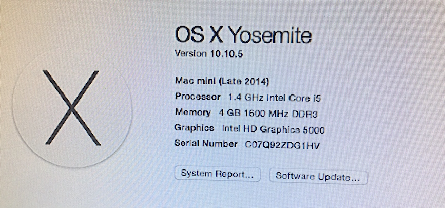

    I'm using MadMapper 2.2.4 on a Mac Mini to run 3 projectors.

    This all worked out great in the past, shown the work a few times using a 180MB video file 2160*1280 (so it can be split across 3 projectors that are each 128*720). The project is an artwork, I just got the kit back from an exhibit and did my set up sing some still images I use for calibrating. All good. Then I loaded a new video (4GB). Playback is fine but I get the spinning wheel of death and cannot edit anything once I load the video and click on "Show Info" to Enable Preview.
    So, I reloaded the previous, smaller, video. Same problem. I also tried with a new version of the 2nd video, saving it as a smaller file (180MB) using H264 Codec (the HAP Codec made the file 8GB ). Specifically it is when I click on "Show Info" to Enable Preview that it all goes horribly wrong. I have to Force Quit to get out. The video is running OK through the projectors, I just can't edit (manage surfaces).

    You can collapse the previews if your performance hit is on GPU side.
    What does Activity Monitor says about CPU usage ? Memory ?
    You should use MadMapper 2.5.1. It contains lots of improvements. You can keep the previous version anyway, and files are fully compatible.
    You can also use "Hardware Acceleration" on your H264 movies (in the video parameters at the bottom)
    Does anything helped ?

    Thanks, mad-matt. I backed up via Time Machine then took your advice.
    1. Upgraded to latest Mac OS
    2. Upgraded latest MadMapper software
    I can move between menus now, though still very laggy. But better! Video is running through projectors just not at 30fps
    Using Activity Monitor prior to this, CPU usage was 120---140%
    With above changes CPU usage is 115-130%
    (goes away and takes next bit of advice...)
    I have turned on hardware acceleration. HUGE IMPROVEMENT. I am so grateful for your advice. Thank you very much.
