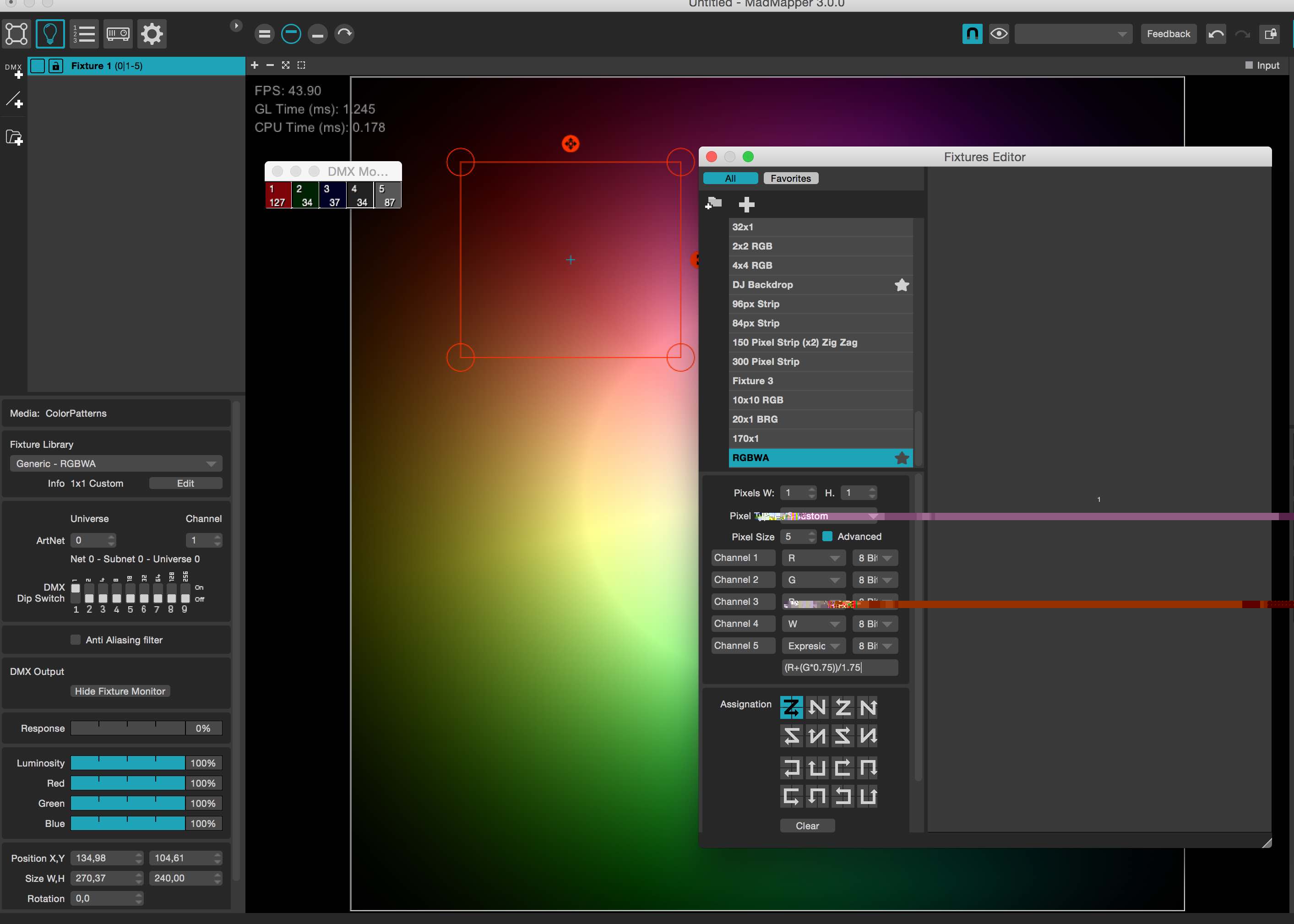

    by mad-matt » Tue Jun 27, 2017 12:42 am
    Like in attached screenshot.
    "W" channel will be fed by the minimum of R, G and B.
    while "L" would be fed by the luminance of the pixel - dot(colorRGB, vec3(0.299, 0.587, 0.114))
    If you want to remove from R, G and B the luminosity you send yo "W" channel, you can use expressions for three first channels too:
    channel 1, expression = "R-W"
    channel 2, expression = "G-W"
    channel 3, expression = "B-W"
    channel 4, expression = "W"
    channel 5, expression = "(R+(G*0.75))/1.75"
    Another possibility is to control RGB with one media, W with another one and Amber with another. For that you would create 3 fixtures.
    RGBXX: channels: R,G,B,Unused,Unused
    XXXWX: channels: Unused,Unused,Unused,W,Unused
    XXXXXA: channels: Unused,Unused,Unused,Unused, expression "(R+(G*0.75))/1.75"
    Then you can patch all fixtures to the same DMX address and each will control certains DMX channels. You can use a gradiant on the Amber channel while displaying a noise on RBG for instance (since you can affect different medias to each fixture, or different input positions if all video content comes from a Syphon source)

    by kazimier22 » Tue Jun 27, 2017 2:53 pm
    ok - sure makes a lot more sense. did not know about the expression function of the custom fixture . that's really interesting.
    i cannot see the attachment in your reply.. could you possible send it again if you get the chance?

    by kazimier22 » Tue Jun 27, 2017 3:59 pm
    no worries. i got it working with the expressions solution - looks great. thanks for your help

    by mad-matt » Tue Jun 27, 2017 9:51 pm
    Oups, file was too big, here it is
