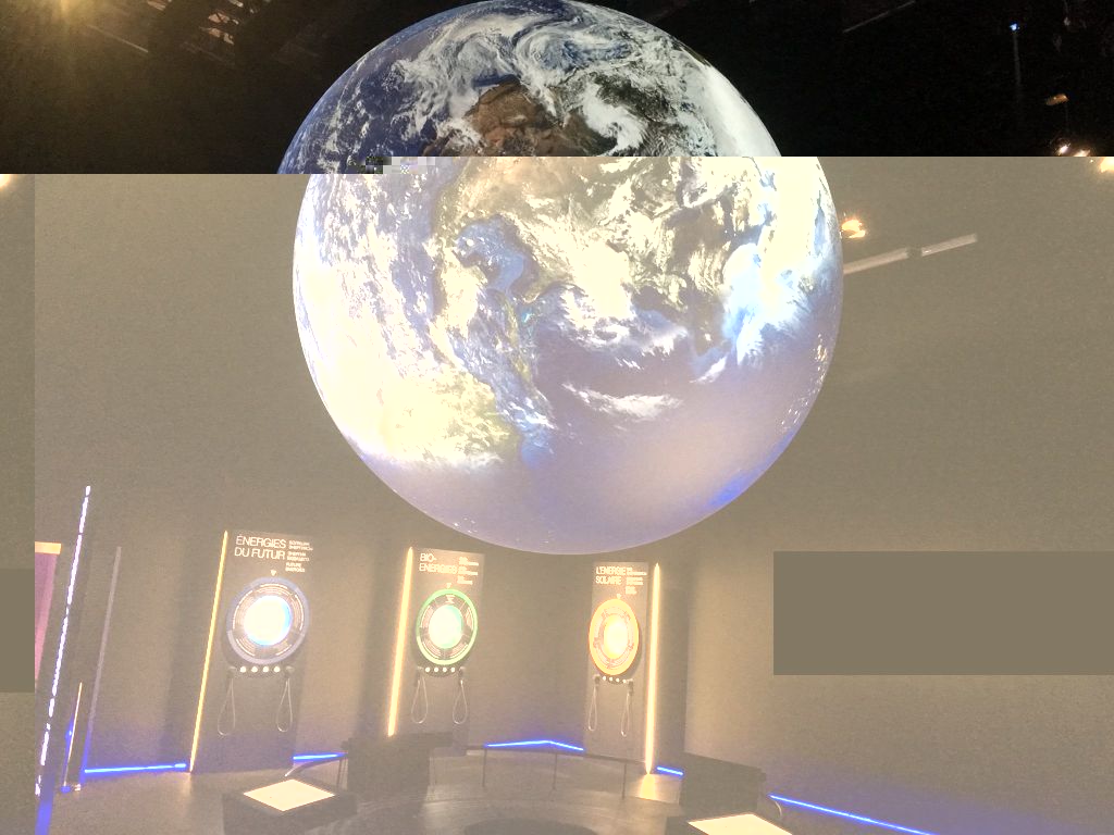

    Do you have a photo of your real object you're trying to map ?

    by TheYouth » Mon Jul 24, 2017 11:24 am
    Actually only from the finished one with Watchout. This one has 3.5m diameter and five projectors.... But next time I want to do it with MadMapper, this is why I´m trying to figure out how it´s working....
    So it seems that I´ve done something wrong like you say...
    As I said: I tried many variants in MM to get it to work.. This one was just an example.
    On the real sphere we marked the equator and every 45 degree or more to have an optical reference.
    So... placing the sphere in MadMapper, rotate it so it fits nearly the real object and then it goes into calibration mode... Placing the reference points where? on the equator? Didn´t worked for me, object disappears...
