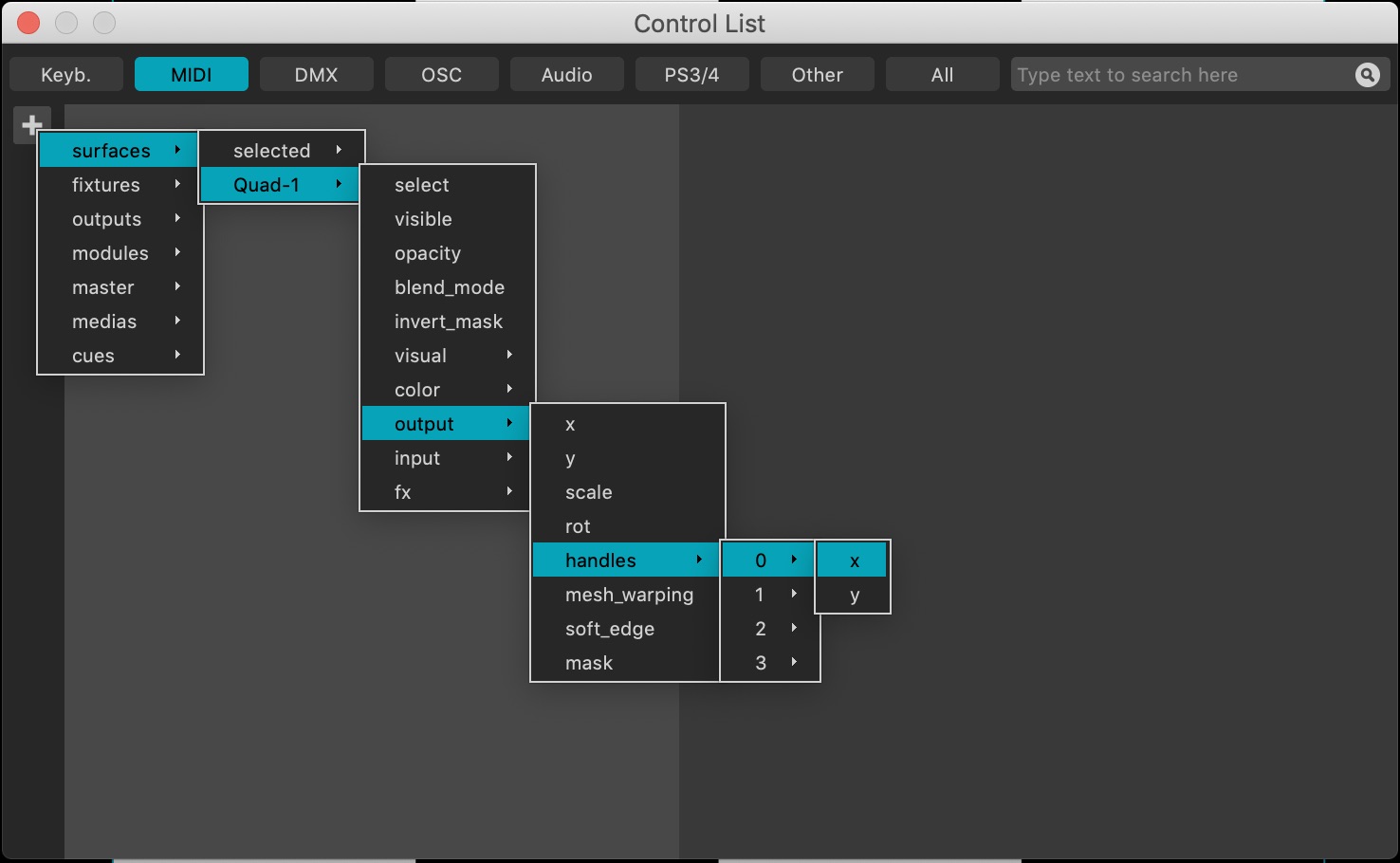

    Is there any chance to get native option to control surface pins via external control (MIDI, OSC, etc)?
    It' most annoying part of every show - to have control on ipad on everything, but those pins……
    Thanx a lot!

    You have it here:

    no reaction in MM on this handles, mapped from any source (midi, osc) at all

    p.s.: control works only for current surface, not for "surfaces/selected/..."

    Okay. Thanks for the report. That will be fixed in 3.7.2.
