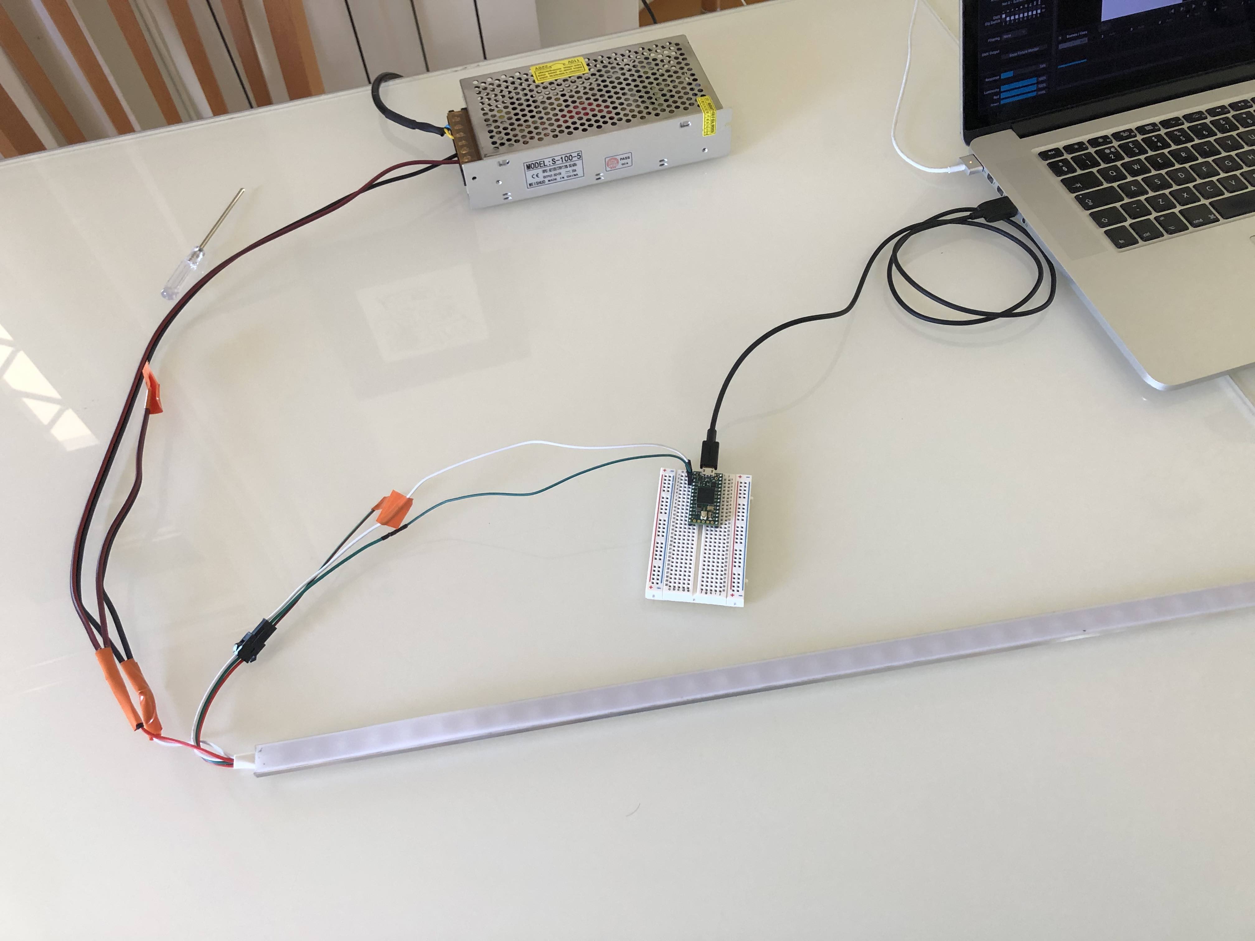

    Hi guys!
    I am putting together a project with 300 LEDs arranged in 5 strip of one meter each. I am using a Teensy 4.0 and WS2812b powered through a 5v PSU.
    At the moment though I am only testing a single strip of 60 LED, with the same set up.
    I get the 60 pixels strip to run the "JUST_TEST_LEDS" almost fine as all LEDs blink as expected apart from the first one which stays on.
    When I then go into MadMapper the strip just behave randomly. The whole strip turn on when just the first pixel is on white and then it goes off proportionally when it goes on black but with some heavy blinking, almost like if there is some kind of interference. If I then push the reset button on the teensy the LEDs stop at the last dmx inputs and stop blinking.
    I probably have done something dumb somewhere (I should mention that I'm a total noob here!) so if anyone could share some wisdom I would greatly appreciate it!
    Thanks.

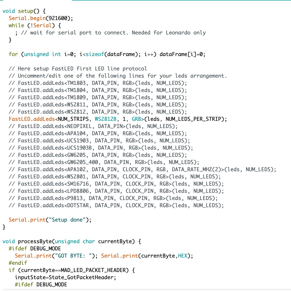

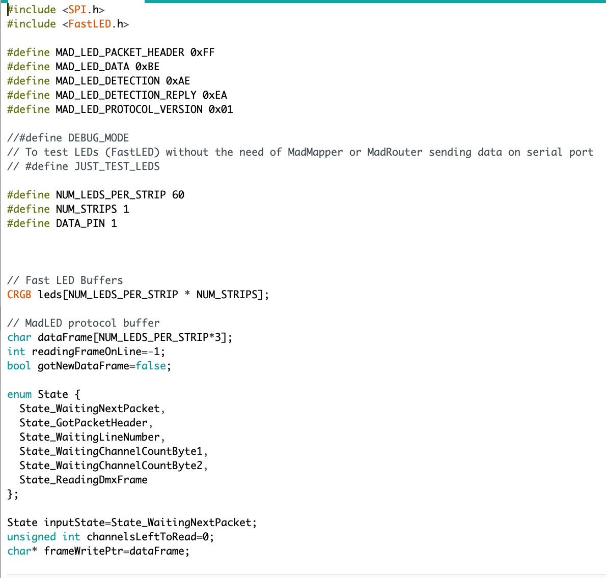

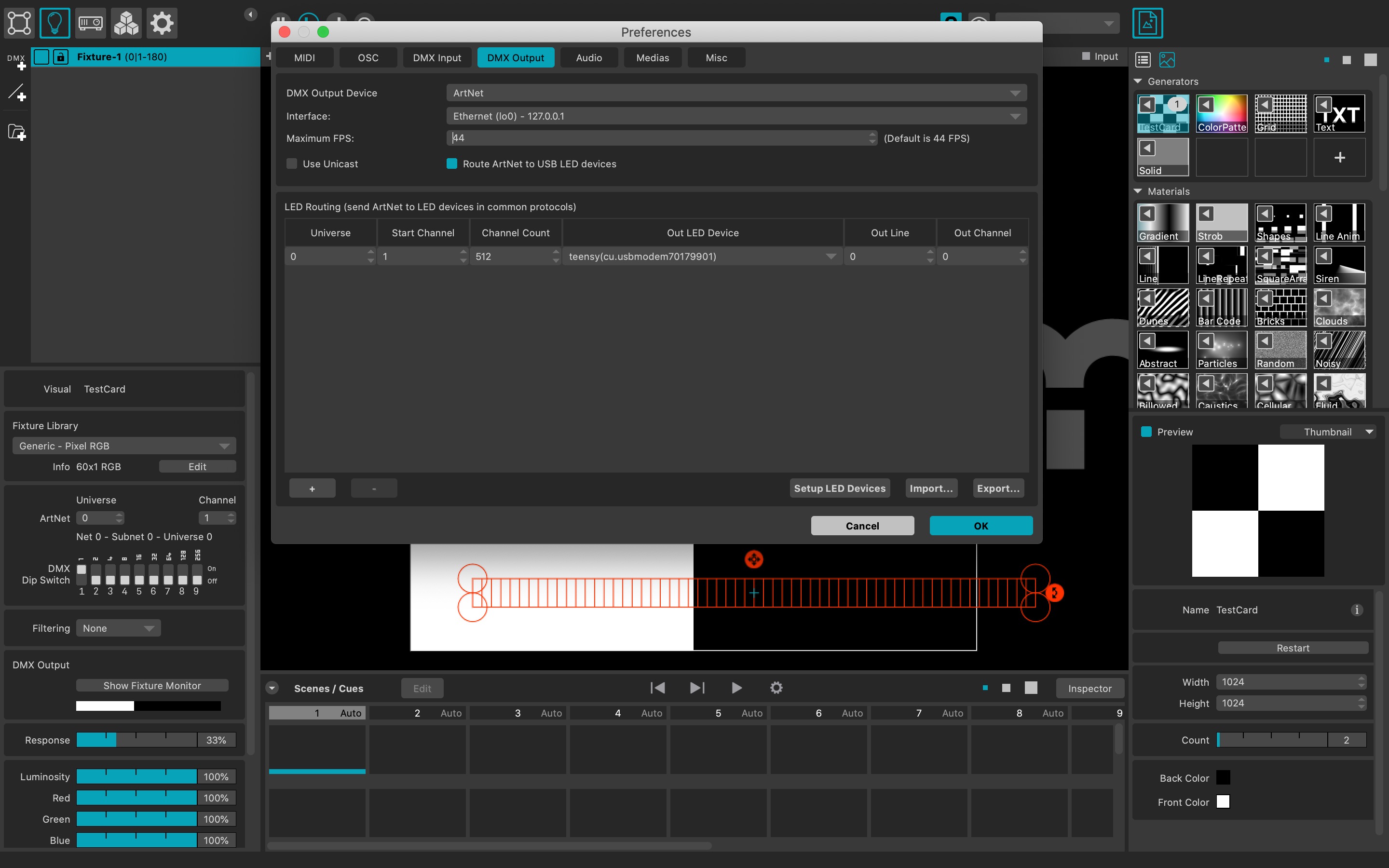

    I thought I'd add a video to show the behaviour and also the code I'm running on Tennsyduino:
    https://vimeo.com/406195519/d4d20ef04a

    If you have the option, prefer using a LED strip with a clock wire, it avoid all timing issues, which is what you have here. WS2812 requires a constant bitrate and we might spend too much time reading USB data before calling FastLED again.
    1- I propose you test this change:
    while (Serial.available() > 0 && bytesRead<30000) {
    processByte(Serial.read()); bytesRead++;
    In this line, replace 30000 with 3000 for instance.
    I haven't tried with teensy 4.0 at the moment, but as it performs very fast there should be no problem.
    Let me know if it solves
    Re: Teensy 4.0 + WS2812B weird blinking
    by mad-matt » Tue Apr 14, 2020 9:18 pm
    Also: Which FastLED library did you install ?
    I never tried with teensy 4.0, I saw last year they released a fix for teensy 4: https://www.reddit.com/r/FastLED/commen ... 0_support/

    Thanks for the reply mad-matt. Changing bytesRead<30000 to 3000 did not work.
    And yes I was following the new FastLED parallel protocol for the Teensy 4 Dalready. I have also added a level shifter since last time I wrote.
    Essentially now everything works but with some random pixels blinking each side of the ones receiving inputs from MadMapper.
    Is not having a Clock pin the only reason or is there anything else I should try? I've already changed strip once (I was using RGBW before and they did not work at all) so I would love not to have to buy a new strip, I'm running out of money :lol:

    I also tried the example sketches from FastLED library and they don't work properly either, while the ones from Neopixel, like the strandtest, work perfectly.
    I think that should mean that the problem is not in the wiring or soldering, right?
    by mad-matt » Sun Apr 19, 2020 3:56 pm
    If you have a sketch working properly it means that cabling is ok for sure.
    Which version of FastLED is installed in your environment ?
  • Simonluca
    Joined: Thu Apr 09, 2020 6:02 pm
    by Simonluca » Mon Apr 20, 2020 11:38 am
    I am using FastLED 3.3.0 and at the moment I have two parallel output of 120 pixel each.
    I tried the FastLED-simple-test.ino and it works properly, same goes for other Examples sketches from FastLED library, except some problem with FastLED.delay().
    But when I uncomment #define JUST_TEST_LEDS on the the sketch FastLED-serial-only-single-line.ino the blinking it's very jumpy.
    And when I lower the bytesRead<30000 to 3000 or 300 or 100 it gets worse to the point where there's no blinking anymore, the leds just stay on. I have also tried to rise it and that doesn't work either.

    I don't have WS strips here. Next time I go to the office I'll take some. Sorry I'm not able to help you at the moment. Maybe there's a USB communication issue ? No idea what can be happening.
    Maybe you could try to just send data for 30 LEDs on a single line (change routing in MadMapper and reduce LED count in arduino sketch), then if it works, increase LED count, then if works, add the second line... You might understand where the issue starts happening and we'll understand where the problem is.
    Does the problem happens if you send a moving line from MM with a lot of black (so you reduce power consumption) - ie "Line Patterns" material ?
