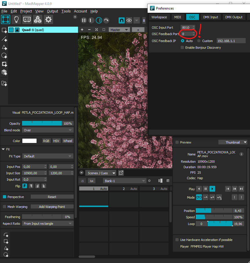

    I am making a simple content control system for the client using Open Stage Control and MadMapper.
    I want to make a fader that works like playhead on timeline.
    I did it, but the problem is that MadMapper doesn't feed Postion to Fader.
    I would like the fader to follow the Position Value.
    Is it possible at all?
    What could be done here?

    I receive the feedback in my test (on movie position). What did you set as OSC Feedback IP in MM preferences / OSC ? If you set it to "Auto" MM keeps a list of all IPs which sent OSC to MadMapper and they will all receive OSC feedback.
    I found a thing I was doing wrong that I forgot:)
    Now, when I entered the correct feedback port, everything works fine!
    Thanks a lot for the feedback, it helped me not to lose hope and find a problem :D
    Zrzut ekranu 2021-05-02 175044.png (431.76 KiB) Viewed 3157 times
