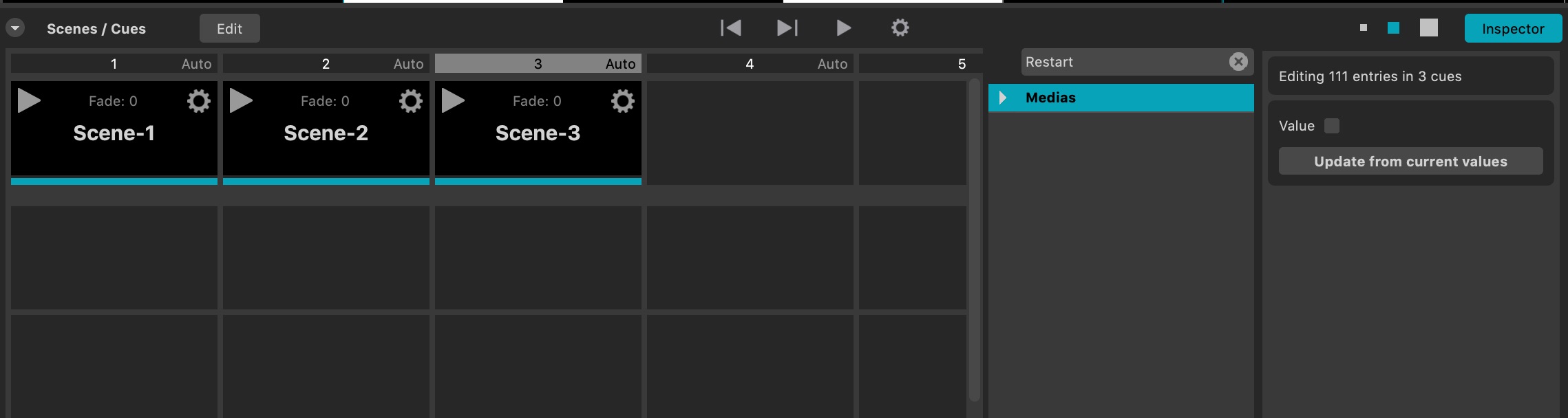

    by mad-matt » Wed Oct 16, 2019 9:39 am
    Wechanged that in 3.7.3.Which version did you use to created your scenes ?
    Anyway, you can disable the movies "Restart" setting in your scenes from the Cue Inspector. Just select all your scenes, open the Inspector (inspector button is on the right side of cue bank toolbar), type "Restart" in the search field, select all items in the list and uncheck the "Value" checkbox on the right. See attached screenshot

    by Robbie the Robot » Wed Oct 16, 2019 3:49 pm
    Thank you for the quick reply.
    I'm using 3.7.3. I checked my project again, and yes all the scenes are set to Restart in the inspector. Since most of my movie clips are loop-able I didn't notice that they too restart as they fade into other scenes. I was able to fix the restart behavior as you showed me, but it took me a few tries because the scene that's giving me the problem is Play Once, not looped. I need it to restart when I select it but not suddenly restart when it fades into another scene. Maybe I'm missing something, but it seems to me that a loop restarting as it's being faded out is not such a useful feature. I can understand that you would probably want a clip that is being faded in to restart, but why would you want the clip that is fading out to suddenly go back to the beginning just before it fades into another clip?
