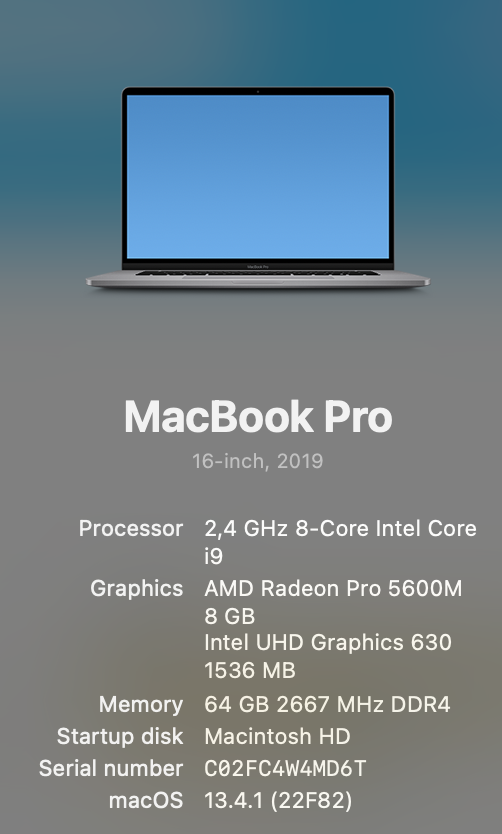

    For anyone (like me) finding this post 2 years later, who has similar audio problems with the audio module in mad 5.3.2 on macOS:
    I was getting glitches with both .mp3 & .wav files playing from the audio module on my macbook, which is a pretty powerful machine (running on Ventura 13.4.1), even when playing a single audio clip was the only thing going on.
    (full specs in attached screenshot in case GC wants to debug this)
    Macbook Specs
    Screenshot 2023-07-13 at 13.27.03.png (178.32 KiB) Viewed 4632 times
