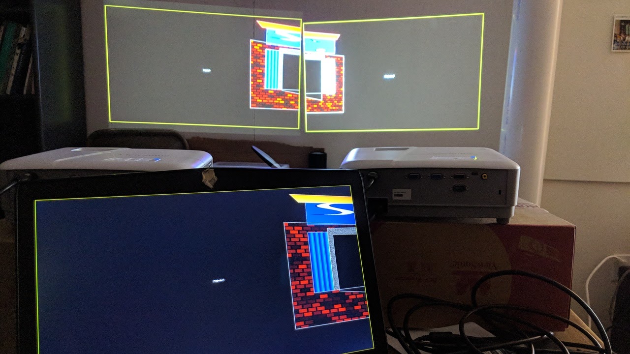

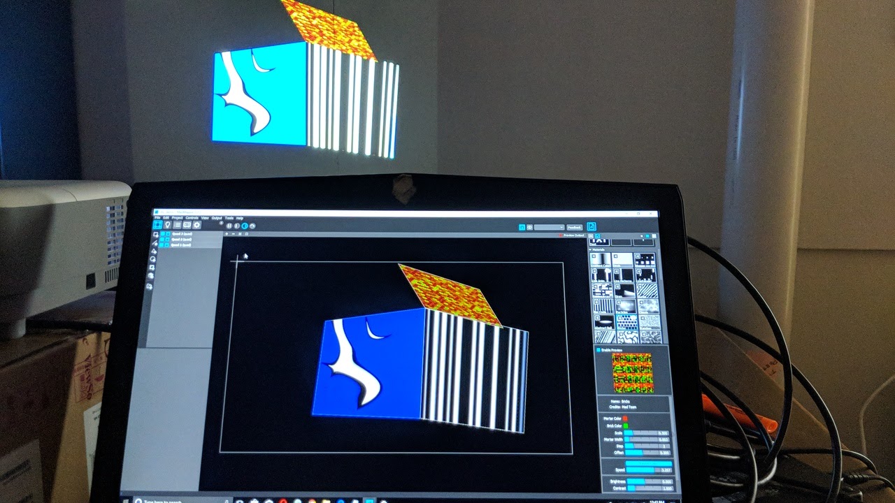

    In the following image you can see I am outputting to a single projector in full screen mode. At the same time I am also able to access the MM interface on my laptop monitor so that I can make adjustments to the projection.

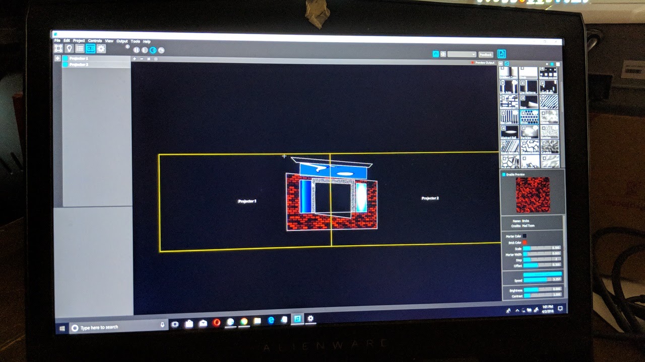

    In the following images you can see that I am outputting to two projectors from the same laptop in full screen mode. However unlike with outputting to a single projector I am unable to access the MM interface to make adjustments to the shapes in the projections.
    How do I output to two projectors and maintain the ability to make changes to what is being projected while in full screen mode? I have watched tutorials and this does not seem to be problem. I am running an Alienware with an Nvidia GForce GTX 1070 that laptop also has an integrated card.
    Re: out to more than one projector?
    by mad-matt » Thu Apr 05, 2018 12:29 pm
    That's a windows display settings issue. One of your projector is a clone of your laptop screen. You should use "Extend Displays" for both projectors outputs in Windows. First link I found: https://www.windowscentral.com/how-conn ... windows-10
