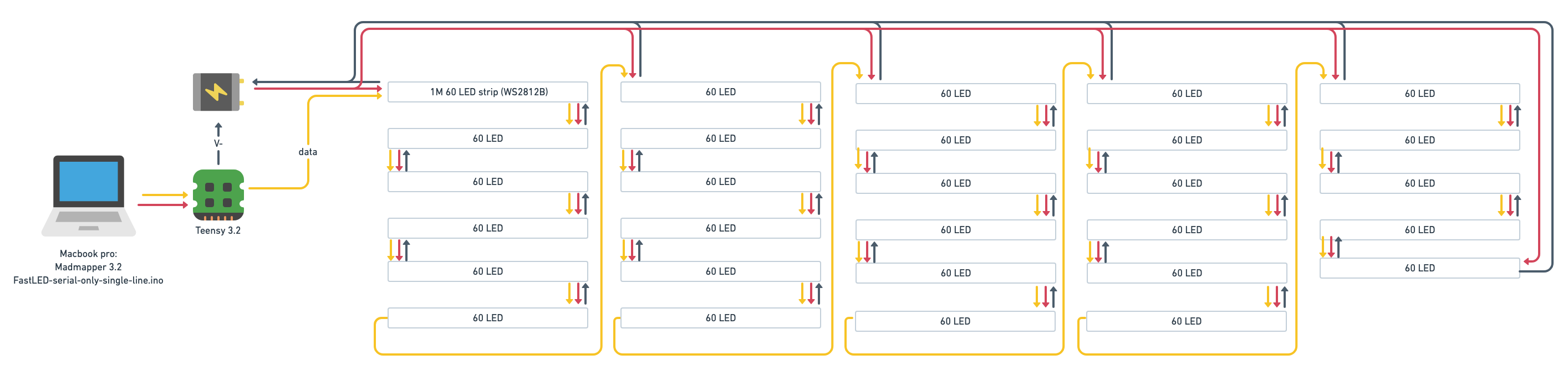

    My setup
    • 28 x 60 WS2812B LED strips (1680 pixels total) connected serially with proper power injection (see diagram).
    • 5V power supply
    • Teensy 3.2 with OctoWS2811 adaptor (I was having issues with the 3.2V data line from the Teensy board, the adaptor upscales it to 5V)
    • Madmapper 3.2
    • FastLED-serial-only-single-line.ino loaded on the Teensy - using pin 7 as my data line (no clock pin, as it is a WS2812B strip)
    DIAGRAM HERE: https://whimsical.co/PkdPBoHgxvs8aU4wczVQ98
    Madmapper LED setup.png (127.62 KiB) Viewed 5669 times
