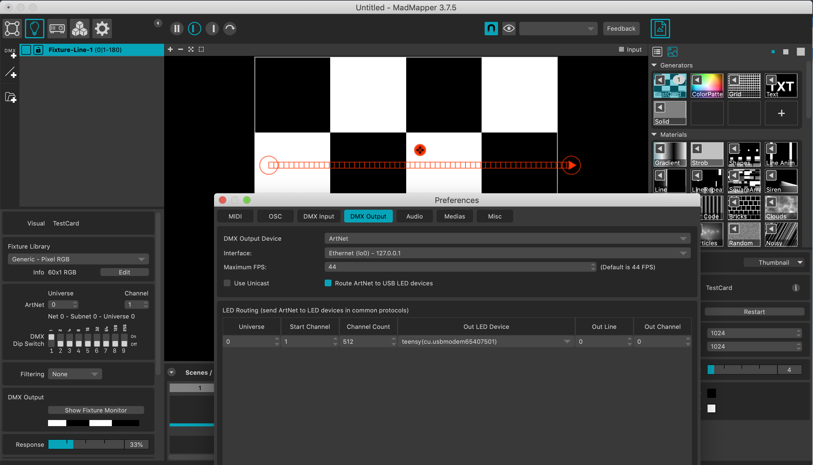

    Can you send a screenshot of you ArtNet => LED routing table ?
    If you use the arduino patch we provide with the line "#define JUST_TEST_LEDS" uncommented

    - when I open Madmapper Led device panel, the baudrate is different from the one in the Arduino code (230400 instead of 921600). I tried to change on the Madmapper side and on the Arduino Side but still get no answer from the led strip. Could it cause any issue ?
    - I tested the Simple Line code with JUST_TEST_LEDS uncommented and it did not work until i introduced a slight delay at the end (delay(5)) to notice it actually fades in and out. I guess it might be because the Teensy 4 calculates too fast the loop so i cannot see it but i wanted to know wether it's a normal behaviour ?
    I join the screenshot you asked and hope we'll find the solution for this issue.
    Screenshot 2020-01-12 at 13.54.02.png (536.57 KiB) Viewed 5905 times
