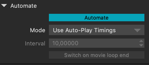

    In MadMapper 4, we improved Cue Scheduler so it can used the duration set on each columns, in Automate / Mode / "Use Auto-Play timings"
    You could have on column 1 your "idle loop", the MIDI/OSC control start the automation of the Cue Scheduler that will trigger columns 1-4 (since you're on column 1 when activating it will start column 2 directly), in column 1 you will manually store the Cue Scheduler Automate with value off, to disable it.
    Does it solve ?
    Screenshot 2020-09-24 at 21.56.14.png (21.44 KiB) Viewed 2778 times
