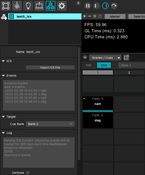

    I'm trying to get the Calendar Scheduler to work here. Basically to run a sunrise, sunset on an installation.
    Testing now with a calendar with four events during four minutes.
    Not getting any events triggering cues.
    I notice that the Events details are greyed out. Is that a problem?
    Bests,
    Birk
    Skjermbilde 2023-03-09 kl. 14.47.22.png (48.66 KiB) Viewed 5314 times
    Re: Calendar Scheduler - not triggering
    by mad-matt » Thu Mar 09, 2023 10:09 pm
    Which MadMapper version ? Please try with MadMapper 5.2.4, we solved an issue with some ICS files and display local time.

    by BN visuals » Fri Mar 10, 2023 7:29 pm
    Yes, this was the solution. Thanks!
