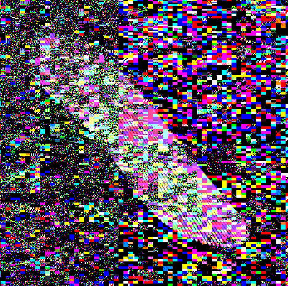

    I wrote a Material that renders fine on my previous MacBook Pro. However, after moving to a new MacBook Pro with an M2 Pro chip, the background of my material (where the alpha channel should be) is extremely glitchy. See the attachment.
    Is there something that I need to change in my code to make it render correctly on an Apple silicon-based processor?
    The following code runs fine on my Intel-based MacBook Pro, and looks like the glitchy mess shown in the attachment running on my new computer. Only difference is that I'm running the M1 build of Madmapper on my new computer:
    Screenshot 2023-04-10 at 9.26.59 AM.png (379.51 KiB) Viewed 4287 times

    It seems that M2 driver doesn't initialize default values for variables, which looks like a good idea. You can solve your shader with
    " float distField1 = 0;
    float distField2 = 0;
    float distField3 = 0;
    float distField4 = 0;
    vec4 color1 = vec4(0);
    vec4 color2 = vec4(0);
    vec4 color3 = vec4(0);
    vec4 color4 = vec4(0);
