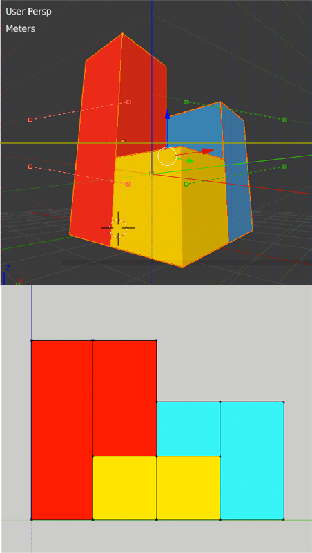

    What software should I use to flatten out a 3D render for image mapping?
    I am creating an augmented sculpture for which we are working with 2D and 3D artists. The 2D guys are working with my blueprint, a flattened version of the sculpture. The 3D guys are rendering art with real 3D perspective. My question is what software do I use to warp the 3D art flat to match the 2D blueprint? The diagram below may make this question more clear.

    Maybe a little late - but what about importing the mesh into Blender. In the UV editor you can unwrap it both slicing it up or project it from view (ortho). Another idea I like is to take it into Sketchup photo match - line it up - from there it is simple to break up..
