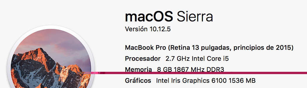

    Hello, Taking advantage of this post. I would like to ask
    For people like me, we have this configuration with an intel iris 6100.
    Are we missing out on the advantages of a GPU?
    Do HAP codecs work on our computers?
    I say that I tried to activate the check box to use hardware support and many times it does not work properly.
    I am referring to the "use Hardware Acceleration If Possible" box found in each video clip.
    Or am I confusing things?
    regards

    by mad-matt » Mon May 22, 2017 3:44 pm
    Hardware acceleration on OSX is using Apple AVFoundation framework. It works for a few formats: H264, ProRes and maybe a few others, and it will work with HAP if you're on OSX 10.10 or later.
