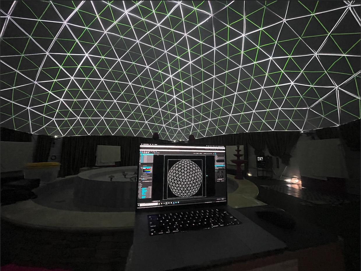

    We have been working with geodesic domes and projection mapping for years and are finally getting pretty decent with the results.
    Depending on the dome and the specific setup there are a few ways to do it. With this post I would like to touch on the method we used and also see if there are any other ways to do it.
    First of all we are using multiple projectors. In this case I am showing we used x7 projectors with a 1:1.09 throw.
    We then had a "flat" image of the dome struts as a test pattern. This dome had the membrane on the outside so we could leverage the cool architecture and have something to map onto.
    The trick is to use enough mesh warping points to adjust all of the triangles and get them super precise. This can be tricky as the mesh warping is in a rectilinear grid while most all geodesic domes are an icosahedral grid. If you throw enough points at it you will eventually get super close.
    When it comes to blending the projections either the "soft-edge" approach or blending them along the struts seems to work great.
    See attached photo.

    For anyone else in the future here is an image of how the mesh warping was applied to the slice of the dome.
    Given you have to apply a square mesh warping grid to a non-square dome grid you will have more points in some areas and less in others. You can always add more with a right-click add point if not enough.
    Definitely tedious but worth it! Plus, if you use the same projector layout in the future most of the work is done.
