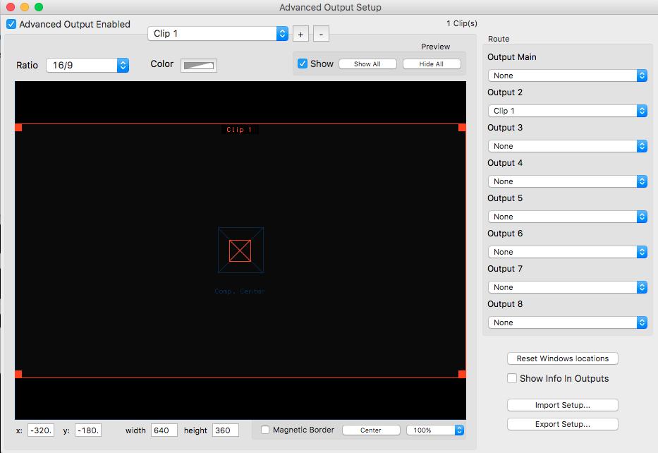

    like this...
    Screen Shot 2018-03-04 at 14.46.18.png (79.52 KiB) Viewed 10538 times
