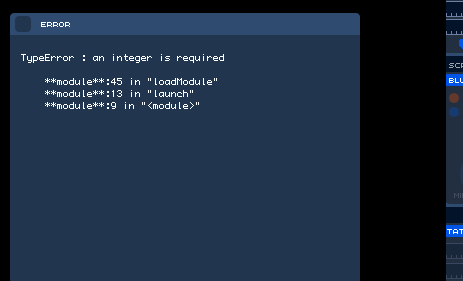

mapmapmap error.jpg (49.34 KiB) Viewed 8507 times
hi,
using MapMapMap-1-1 it either crashes, or i get the errors as per the attached image..

. i just tried and it crashed my Modul8 as well..
. i see to recall something about the code downloads a binary from anomes.com (?) - and it was written w/Python 2.3 whereas Modul8 is now using Python 2.5…
. looks like you can report a bug @ http://www.anomes.com/mapmapmap

This is correct, Anomes has unfortunately not updated mapmapmap to use Python 2.5, and doesn't seem to intend to do so. However, you can put these files: inft.ly/agtvkmd here: ~/.modul8/shared/python/0.41/shared/audio, and that should allow you to use it again.
Please note that this is a workaround, and that we are unaware of the side-effects this might cause.
