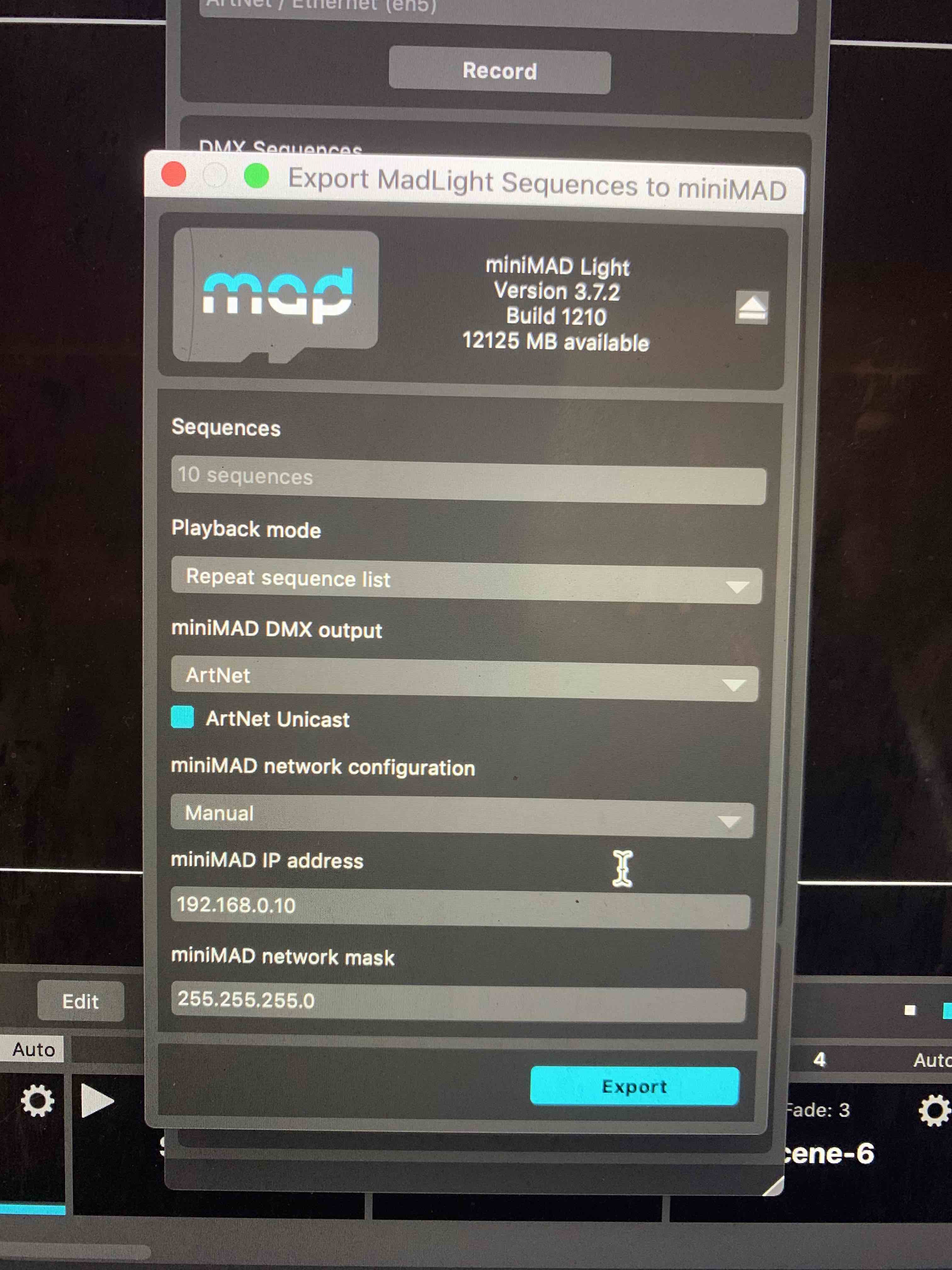

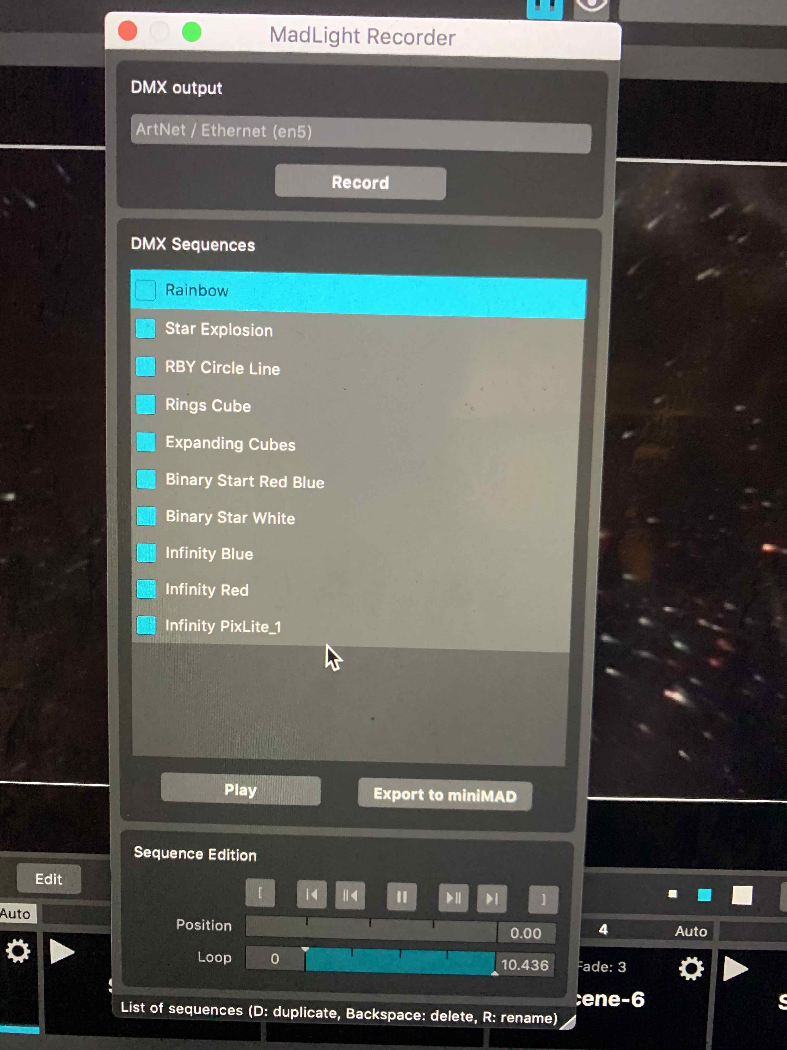

    I am experiencing very strange behavior with my miniMad. I am using the minimad recorder to export scenes using artnet unicast to a pixlite MKII controller (MM Version 3.7.4). After I load the SD card and power up the miniMad, after about a 1 minute boot cycle, the lights come on and function as expected, running through all the scenes and looping back from the beginning. However, after I power down and power up again, the lights come on after another minute or so but then go out after two scenes. The third time I power up, the lights never come on. In subsequent attempts, the lights sometimes come on, sometimes do not, but they always shut off after one or two scenes.
    The same behavior happens (works first time, fails subsequent times) every time I reload the SD card.
    Attached are my madlight recorder settings.

    I am using a Pixlite Mk 2, I am always turning off the controller when the miniMAD is shut down (they are both on the same power strip). After much experimentation, it appears that the miniMAD does not fail if it is uploaded with the "play sequence in a loop". setting (not the repeat sequence list setting).
    I was able to get it to work after multiple power cycles by recording my entire show in one go without using multiple sequences. This makes me highly suspect that it is an issue with the Pixlite. Do you have any resources you can point me towards to understand how to monitor the miniMad with Luminet? The software seems to be quite extensive.
