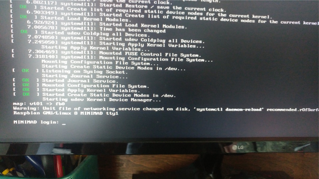

    I downloaded the 8GB image from MM Yourspace account and put it on a 16GB card. I have a blue version of the miniMad (not sure if that makes a difference). I tried downloading the 16GB version, but the download would be corrupt by the time it would finish.
    I power it on and it goes to the logo screen before asking for a raspberrypi login:
    I tried all of the basic root or pi usernames and standard passwords to no avail.
    Thank you. (Posting here in case anyone else has this problem).

    Hello Benoit. I was unable to download the 16GB image without corruption and I could not compare MD5 (even using wget the file fails upon extraction). The 8GB version downloaded successfully and is asking me for a login. Sometimes it boots past the madmapper logo screen to the color button selector, but after that, it reboots and asks for a login.

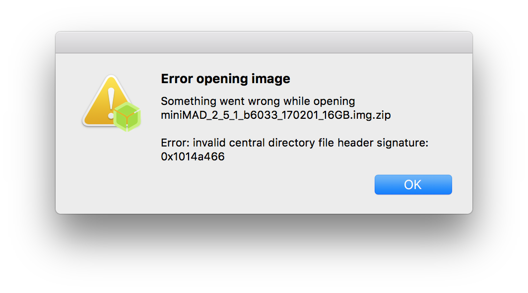

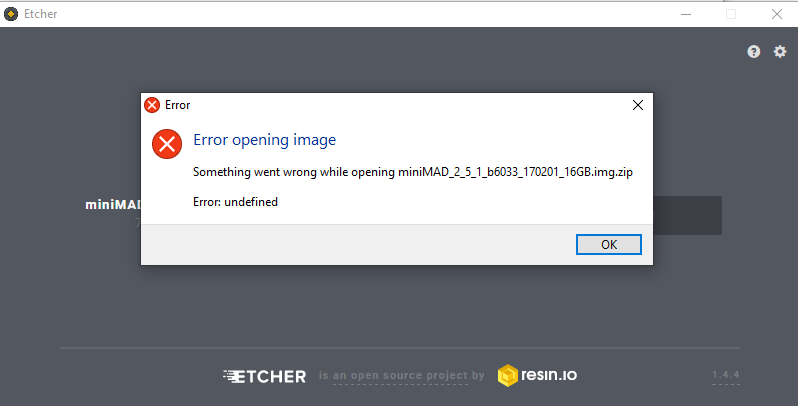

    Thank you again, Benoit, for replying. Unfortunately every time I download the 16GB image I get this error in Etcher (attached) One is from the latest version of Etcher as well.
    It happened once with the 8GB image but the second download worked for that. Unfortunately, the 8GB image is still asking me for a raspberry pi login.
    I don't know a better way than using wget to fetch the files from your server.

    I re-downloaded the 8GB version and used the latest version of Etcher and it asked me for the MINIMAD login. (see image)
    I used a default pi, raspberry login, and now I'm at a command prompt, but this mM isn't auto launching.
    Thus far I have downloaded the 16GB version at least 9 different times on three different computers. Below is the error Etcher gives when trying to use the 16GB img. Is it possible that your upload of the 16GB image is corrupt or incomplete?
    Please advise. Thank you.
