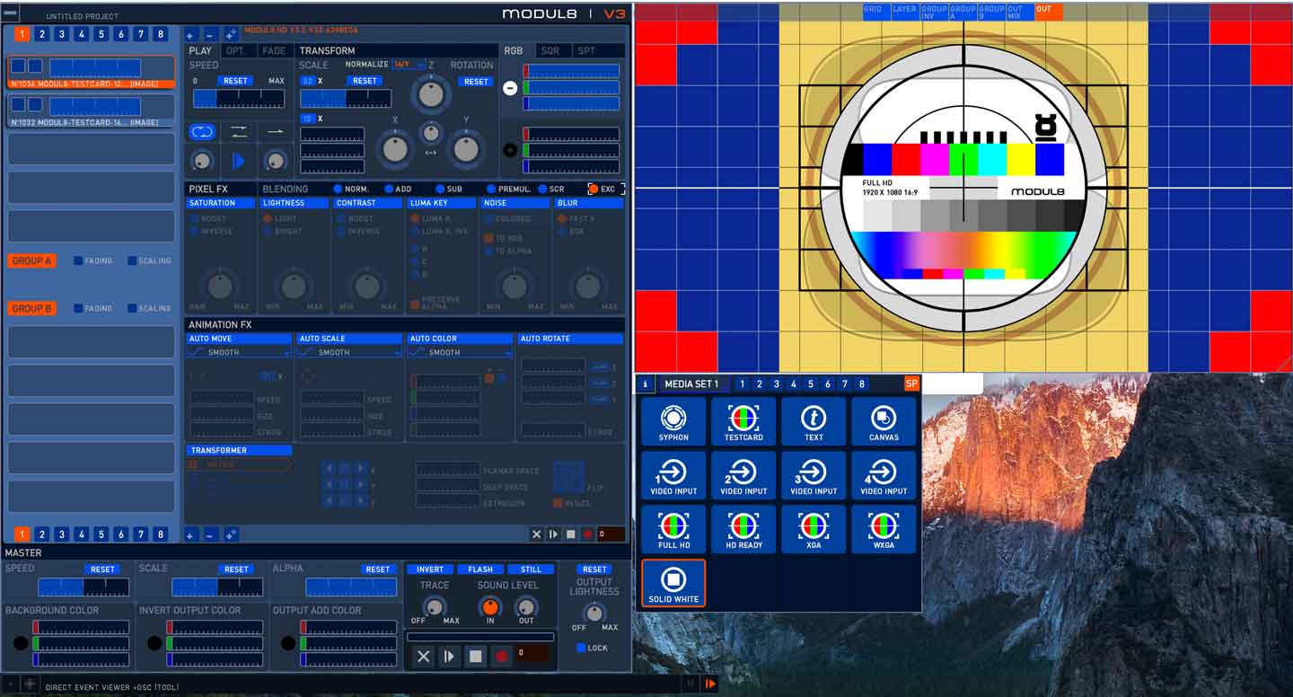

Here's the simplest example I could make (testcard as a background and a white square on top) trying to replicate your problem:
ADD
v3
v2
SUB
v3
v2
EXC
v3
v2
I can't see any difference between version 2 and 3 regarding the way the blending mode works.
Couldn't it be some running module that messes with the blending on either version?

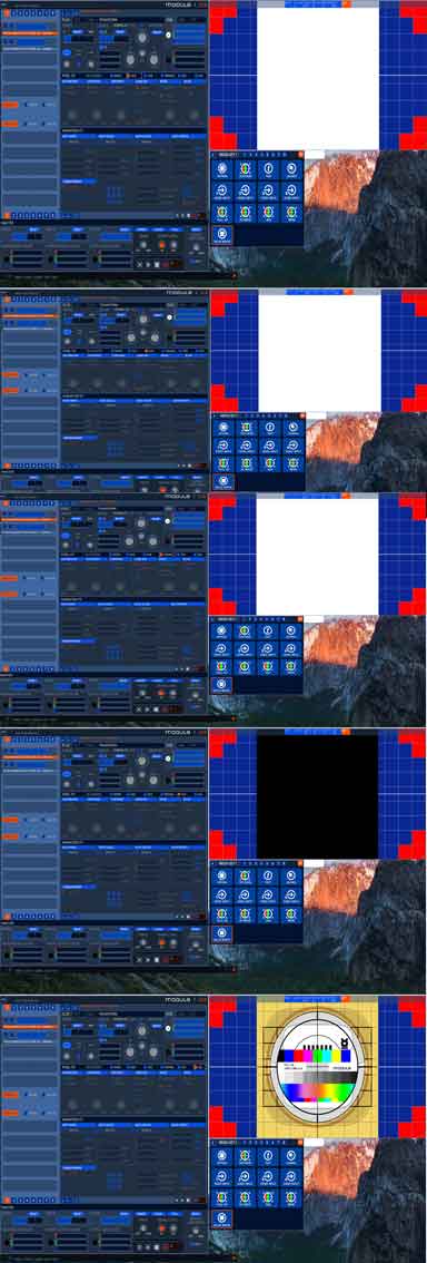

from top to bottom
add
sub
premult
scr
exc
here you can see that only "SCR" and "EXC" are like they used to be ...

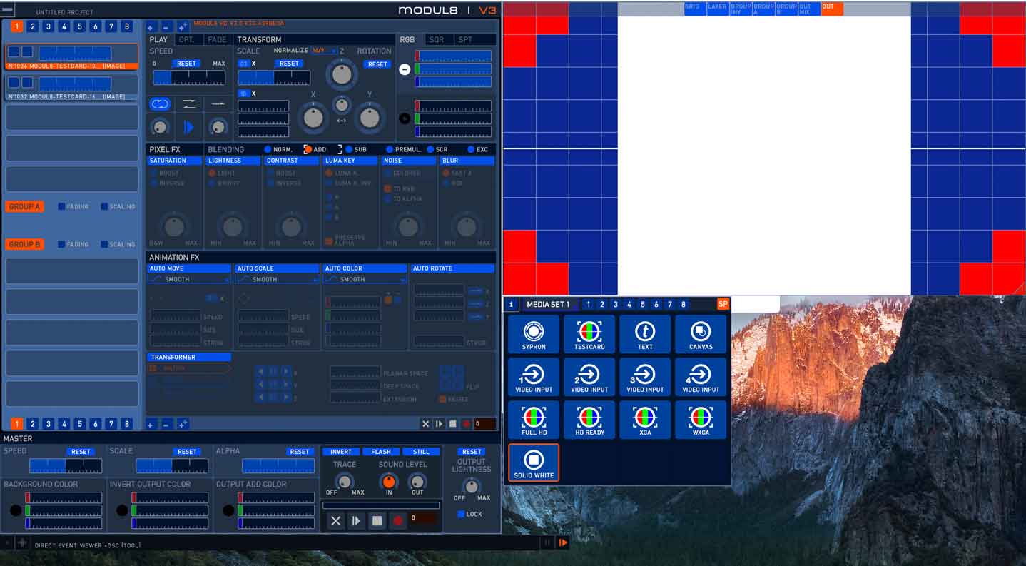

add
add

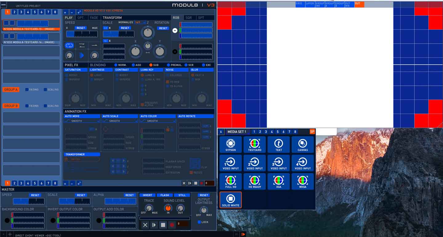

sub
sub

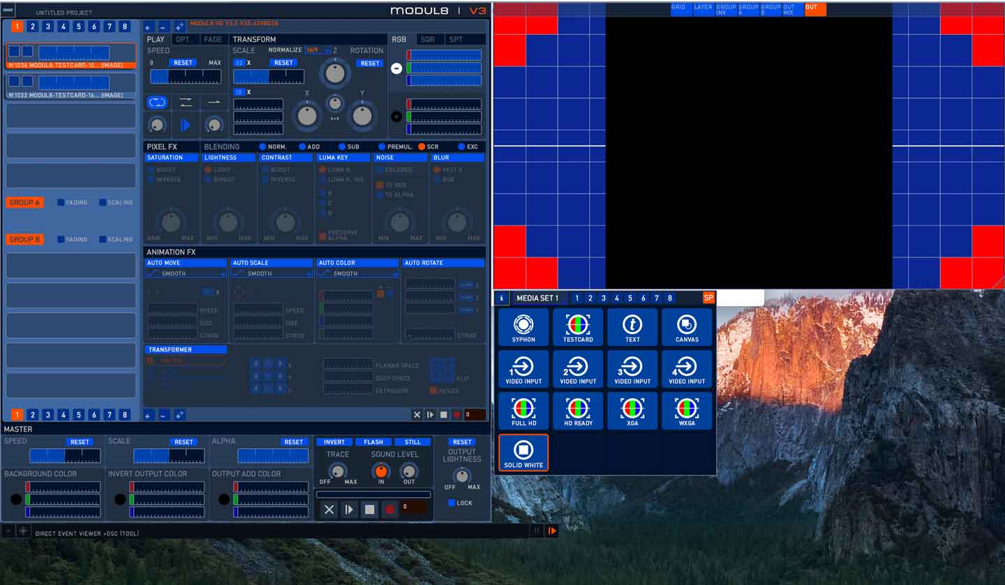

EXC
EXC

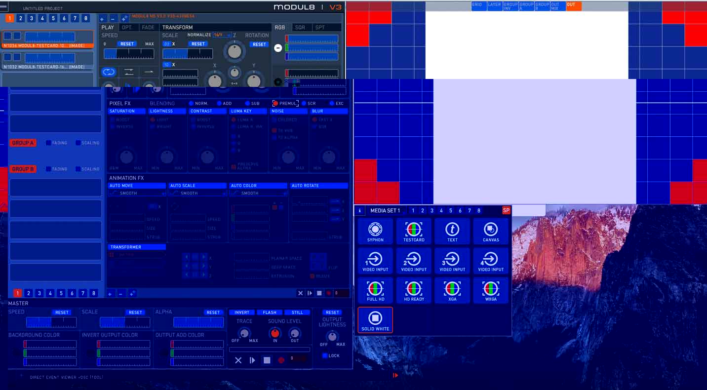

And the question was:
can it be the graphic card I am using?
Bildschirmfoto 2016-10-27 um 17.44.45.png (44.46 KiB) Viewed 9872 times
Re: SUB works like ADD
Posted: Mon Oct 31, 2016 11:58 am
by Pierre Guilluy
Hi Peter,
Thanks for sending the graphic-card model you're using:
I just ran my tests again but forcing the integrated Iris GPU this time instead of the discrete one and I can reproduce your problem.
I will now go through a debug session and let you know.
Pierre
